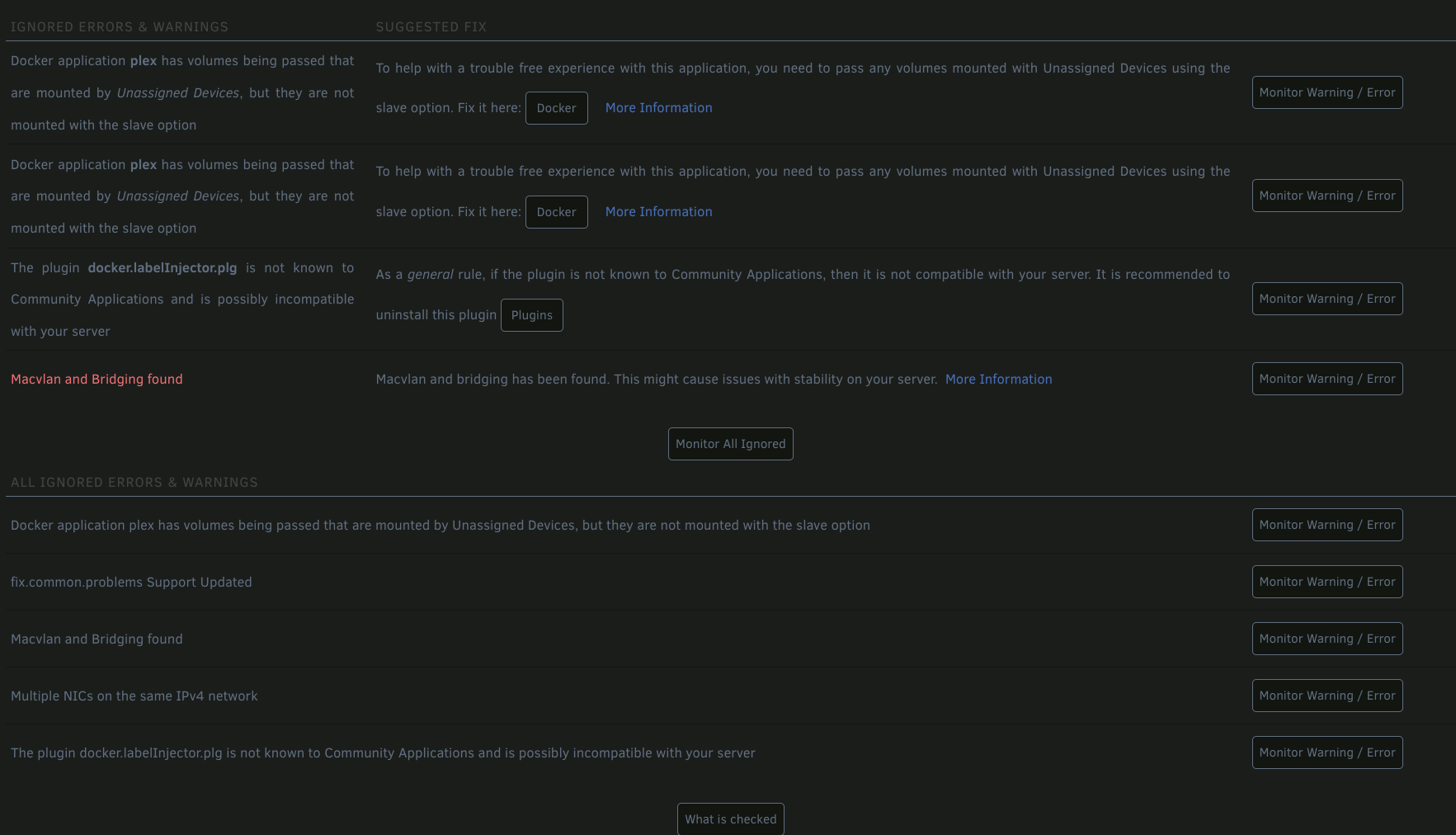

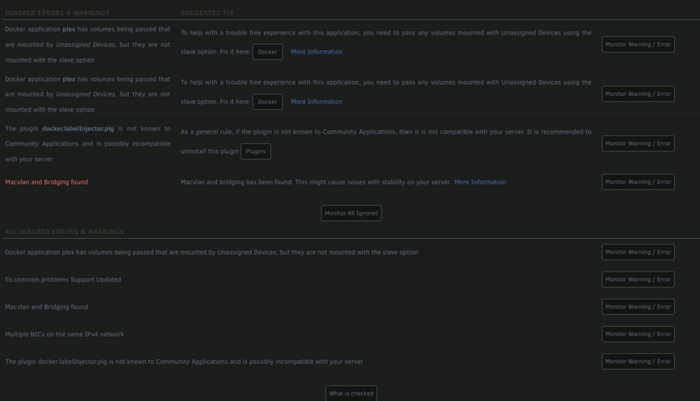

Espressomatic Posted September 9 Share Posted September 9 (edited) Request: Is it possible to get a page-fold feature added to hide ignored issues? 2/3 of the entire rendered page is ignored issues. Issues: The Plex slave shares issue is duplicated - two identical entries. I have 3 shares done like this in the Plex docker config. I'd expect the issue to show 3 entries, but only 1 ideally since they're all the same. The second NIC is bonded to the first and in fail-over mode on one system. On a second system the second NIC is disabled/shut-down and not on the network. Monitoring and re-scan made the NIC items disappear - they were left-overs from initial setup. Oddity: Also odd that everything except "multiple nics" is always repeated twice in two sections. The repeated nics comes up as expected, only shown in the bottom "all ignored" Edited September 9 by Espressomatic Quote Link to comment
