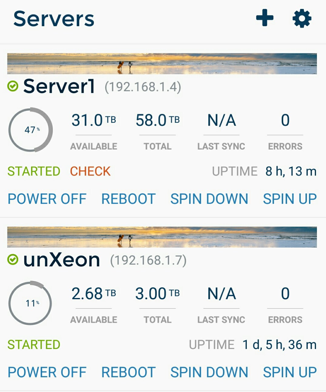

They say a picture is worth a thousand words  :)
Good work  :D
Good work  :D
Wow, that's great !
