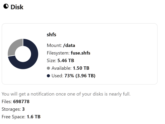

data for container alone ? or you are saying the 2TB of my data ? I dont have any resource to even copy them elsewhere.
app data and db are ok.. they might be small , data here refers to which one ?

Backing up almost 5.5TB will take me years , since most are photos and will take so much time.. If it was simply movie files , trasnfer to ext hdd will be fast.
So i have two options , in both options i have to backup my data .. one option is hop through multiple version and hope i see the light at the end of tunnel , second is erase the path and pray you draw the same path for the DB to work properly.. :(
