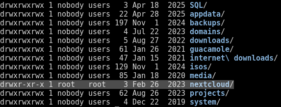

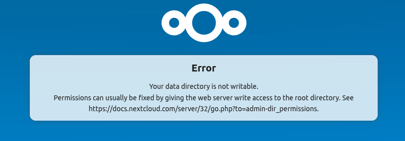

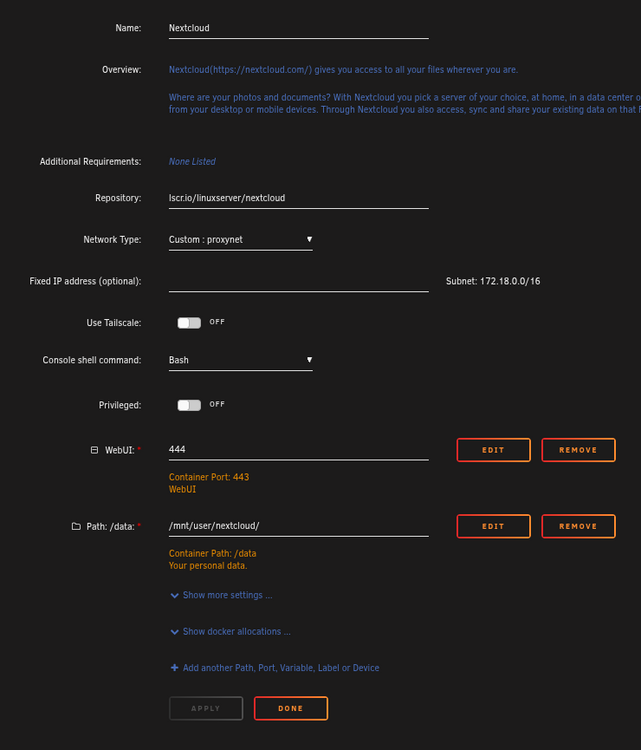

Any ideas why this thing all of a sudden decided it no longer likes the permissions on my data directory, which has worked fine for years and even immediately after the most recent upgrade (done 2-3 days ago)? It just randomly started some time between then and now, and nothing else has changed.
I can access and browse the data directory just fine. I can access the database just fine. The application even works on my devices. It's ONLY this web interface giving the error both locally and through public URL (using Swag proxy).
The link doesn't even take you to a valid URL so you just get forwarded to the main page of the documents, with no information on how to fix it.
Container settings;
Share permissions:
Edited by carnivorebrah
