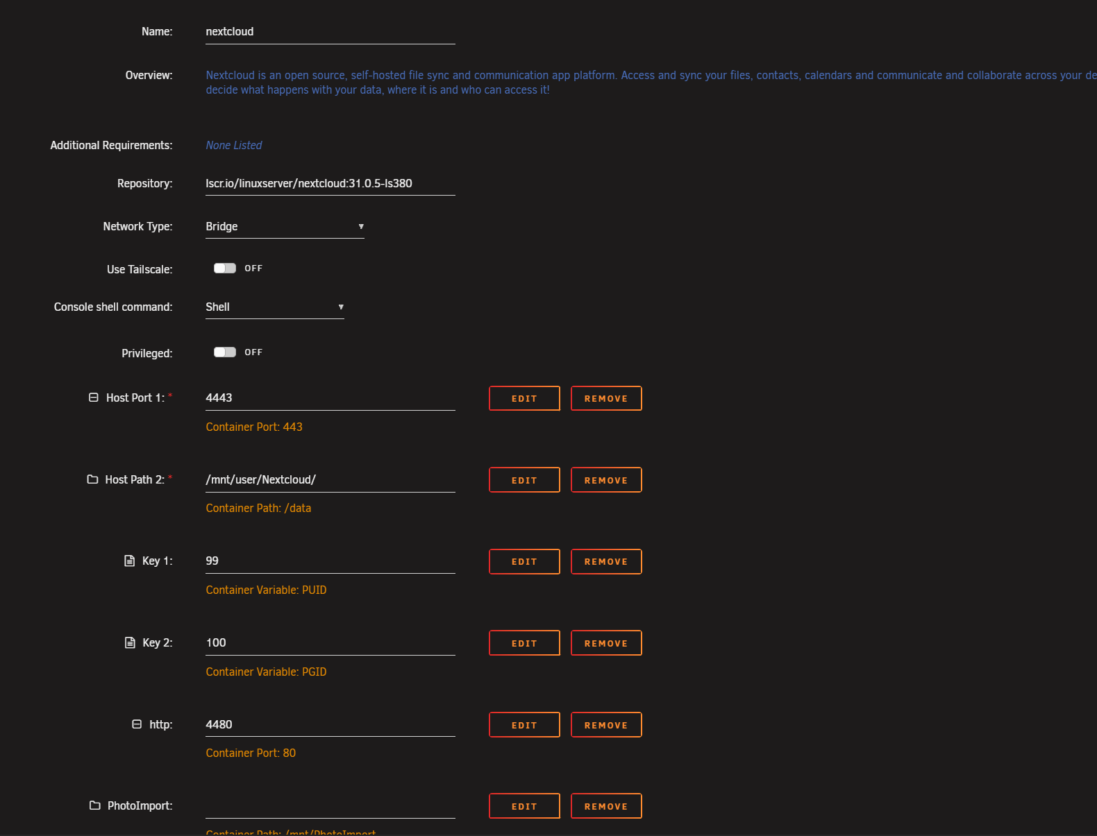

On 6/24/2025 at 2:50 AM, Geck0 said:
Why would you move it, when you can just rename the folder?
I've only briefed through this, so some of it may be assumption. I've pulled back from responding on this thread as I've realised people want the answer, but don't want to look for it. I started like you, and learned from mistakes and trial and error.
  1. Always have backps of important data. Don't know why you would want cloud storage backup, which goes against the idea of having NC in the first place. To answer your question though, yes you can backup to cloud storage, you don't connect it through Nextcloud, you use a utility like rClone and script it to backup to the cloud.
  2. It sounds like you're not familiar with Nextcloud's workings. So, upgrading from 27 to 30 will be slightly difficult for you, as the database needs an upgrade as well between 29 and 30 if I recall. You can do it, by searching through this forum. It was raised this year, as a few people were having problems.
  3. You can keep your configuration, as long as you retain your config.php file, which doesn't get overwritten when you upgrade.
  4. When you upgrade, you do it by changing the docker's lable to the desired version. I would suggest doing this first and stepping through the major versions. You don't have to upgrade every single release. But, when you get to v.30 you will need to upgrade your database's tables, which people have strugled with. So, if you're going to upgrade, only go up to v29 first by upgrading versions. ie. v 27 ---> v.27.5 ---> v 27.9---> v. 28 ---> v 28.5 ----> v 28.9 ---> v 29 ---> v 29.9 (whatever the last version is of 29). Hopefully, you get the idea.
  5. (Alternatively), you can drop your NC and your database, delete the appdata folders for both from your appdata folder and start again at v30. What I can't tell you is if you're going to have to update the tables manually anyway. So, you might as well do point 4 and learn something.
  6. You're not going to lose your data during an upgrade, unless you do something stupid. NC references your data, it does't manipulate it. What would it mean to you, if you lost the data now? If you think you would have that sinking feeling, where your balls are in your throat, then it means something to you. So, back it up. Drives fail all the time, unRaid has redundency, but thats not the same as a backup and you can still lose your data.
  7. There have been several instances on this thread where people don't know how to upgrade correctly and its been responded to many times. I suggest you go and look at those first, search under my username because I've responded to examples like this several times.
  8. If you're really concerned, then create a second instance of NC and database, with the lastest version, referencing a new data folder. Once that is up and running, you can move your data over from old folder to new folder and tell NC to re-scan the files. You won't have any data from your calendar, deck, messenger, etc as that's in the old database, but if your only concerned about your files, then you could start there. After that's done, you can drop your old NC and Dataase from docker and appdata.
  9. Be careful of bad advice.
First of all , let me thank you for posting such a detailed reply.
I did search with my release tag and not much results came , hence posted the question. Also last time when i updated NC, it hung , resulted in some PHP error or some sort and i was very new to unraid at that time. Luckily i was able to see the data and was able to backup it (that time the size was pretty small). Also thats when i fixed the NC tag to specific release to prevent any auto-updates
Now that its grown this much , and i am almost 2 years behind the latest release , I want to be sure and get all details before starting the upgrade. Yes this is the sole backup of my personal and family pictures and videos , which i have compiled from various other small sources. I will first do a backup and stop my phone syncs first and then proceed with your suggestion.
As for cloudbackup , i just want to follow or have some redundancy to my data and felt cloud backup might fit into the 3-2-1 backup. After exploring , found none to be cost efficient. As of now , i do run a parity disk on my unraid. thats one safety net atleast. Will use this opportunity to do a full backup of NC data on to my portable HDD. Will try to connect the usb hdd to unraid server directly and let it backup ? Is it possible ?
As of now , i have only simply uploaded pictures from old bacups into respective folder. What is happening now is i have made my phones to sync with NC and upload camera folder alone to update once i get to home wifi , same goes tomy family members under each logins. With hires images ,they run out of space pretty fast.
other than that i havent used NC a lot , except for face identification extension and duplicate finder.
So if the NC 30 , parallel install is possible , i can do that , or will try.
once again , thanks for your wonderful reply , gives better confidence to move forward.
Also i might have wrongly got the numbers . when i select all the folders it shows only 983GB
Edited by DrSiva2022

Well, I can try to give you a hand, but you'll have to bear with me, I'm really busy nowadays. If you want help, post your docker settings for MariaDb and Nextcloud,
ie.
I can try and help you, but be warned, I'm tied up with a few things that are keeping me busy. If you want help, post your settings page from your Nextcloud and MariaDB dockers, ie.
Ideally, I would need to see the whole thing for both dockers.
Secondly, post your config.php (remember to edit out the personal stuff), like your salted password, domain name, etc.
Thirdly, post your admin settings' overview page.
The reason I need them, people want help but don't give sufficient information and you're trying to help them blind. Lets see if we can get you up to the latest version. Upgrading the tables later is the biggest isue, I can't remember what I had to do. Its documented on the Nextcloud forum, but people had mixed success with the process. I seem to recall I had to do it differently.
