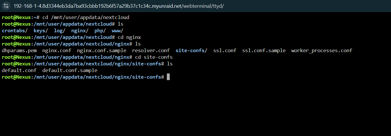

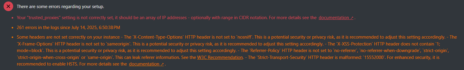

I am trying to address the hardening recommendations for my Nextcloud instance. I get these warnings on the Administration Setting Overview tab.
I've updated every config file I can locate that has the headers mentioned below, but all to no avail. I still get these warning.
Can anyone tell me exactly what config file I should be updating and where to find it?
Thanks in advance for any help you can provide.
These are set in your nginx conf settings. Ideally, you should be running a reverse proxy. In which case set them there, instead of in the nginx.conf file. You'll find them easy to set if you're using opnSense as the revese proxy, as it can be done in the GUI.
Thanks.
I've set them in both the Nextcloud config ssl.conf and in the Swag ssl.conf but I continue to get the same warnings. Is there another location perhaps?
4 hours ago, dius said:
Thanks.

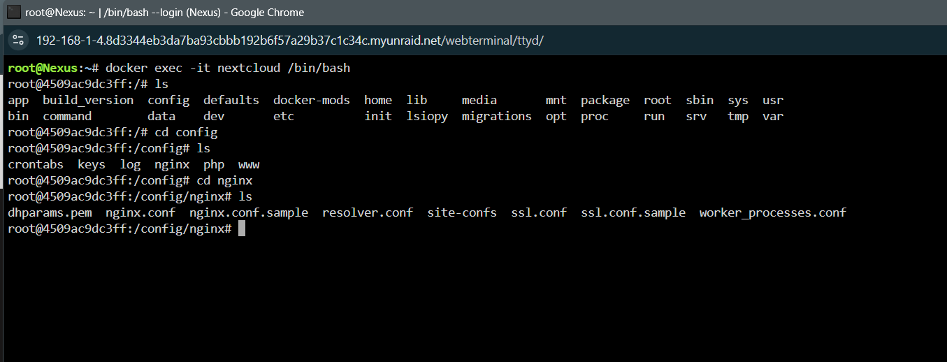

You can access it through your Nextcloud's appdata. The files that need adjusting are "default.conf" and "nginx.conf".
I generally leave default.conf alone and adjust nginx.conf, in fact I haven't adjusted mine in years. When you upgrade Nextcloud, it will keep those files, your config.php file, etc.
Its linked to its actual location inside Nextcloud's docker:
But, you don't need to go into the docker itself.

Hello,
have a similar problem, want to updatethe dcker image, but get this error:
TOTAL DATA PULLED: 0 B
Unable to find image 'lscr.io/linuxserver/nextcloud:28.0.4-ls309' locally
docker: Error response from daemon: Get "https://lscr.io/v2/": dial tcp 3.67.33.93:443: connect: connection refused.
See 'docker run --help'.
I tried t follow lademonkees path but didn't understand, how this will help. I found the tgged versions and then tried to update to the versions with 28.0.4-ls309 starting upwards (by changing configuration paremeter "Repository" to e.g. "lscr.io/linuxserver/nextcloud:28.0.4-ls309", but it seems, that the path to repo in the image is not the correct. What is my fault, how can i update the image?
Many thanks in advance.
Everyone else seeing this with todays update, too?
Yes I'm seeing it. Everything seems to be working for now. I've no idea how to fix this warning. I'm hoping that a subsequent update will fix it ... :)
5 hours ago, kSmKcW9XJ1yCN2ejHX3s said:
Hello,
Go to Google and type "linixserver.io nextcloud" it will take you to the repository for linuxserver.io. Look for the latest version that you want abd copy abd paste the label into the dockers edit section.
Ie. Copy andd paste the title (lable) of the version, as per the image Ive attached. It would have been useful for you to copy and paste what you have in your dockers edit section, as its likely a pull issue with what you've edited. You may not want the latest version anyway, if you read above, two guys are reporting a problem.
I do feel like we've seen this before and it WAS fixed in a update...been a long time though. Hmm

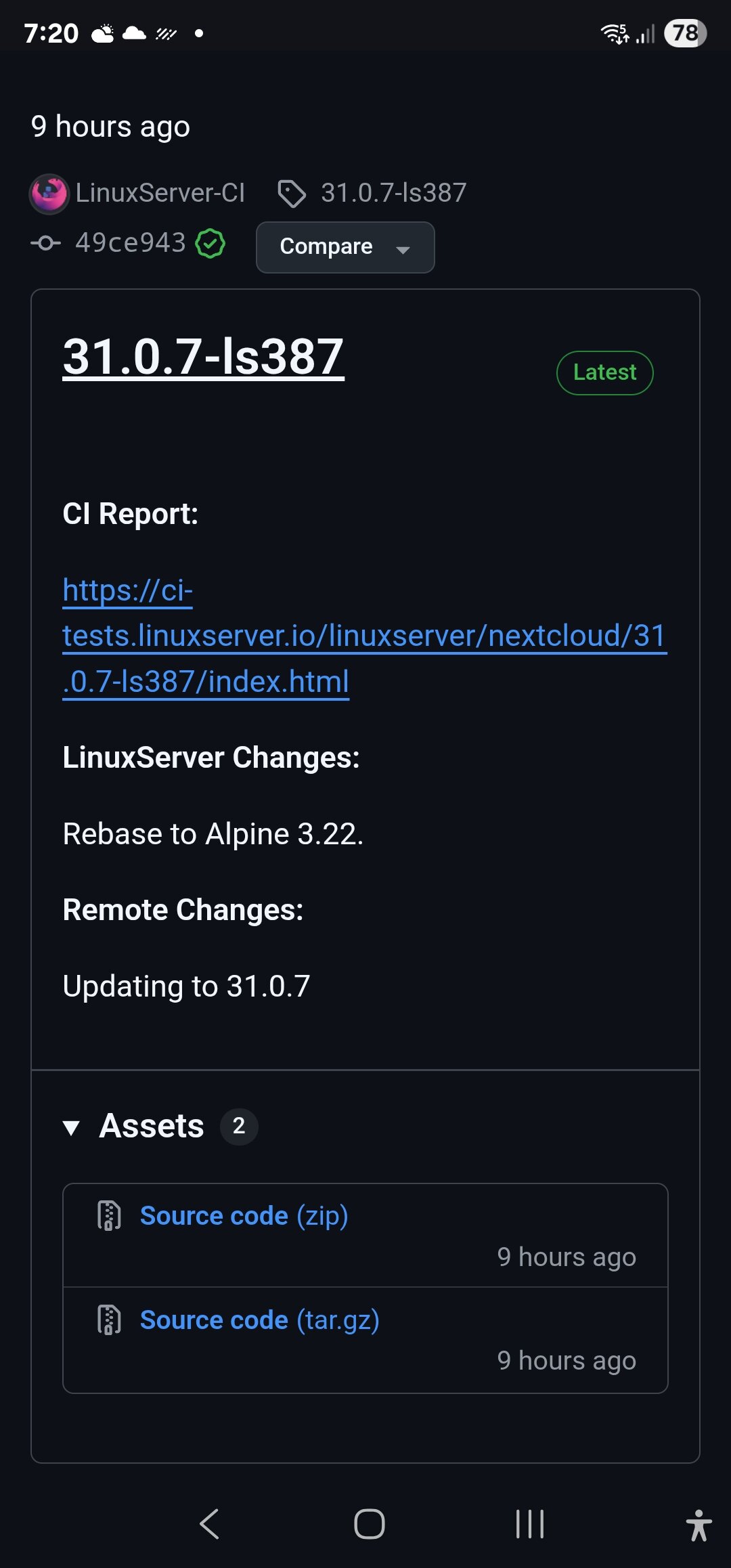

Any word on if the new version (just now published by linuxserver) has the same warning or not? I held off upgrading last week when I saw your post.
