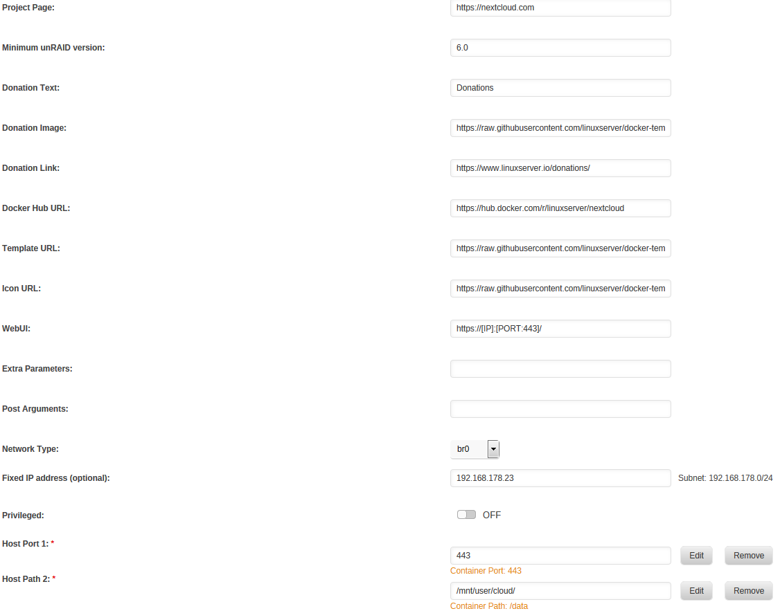

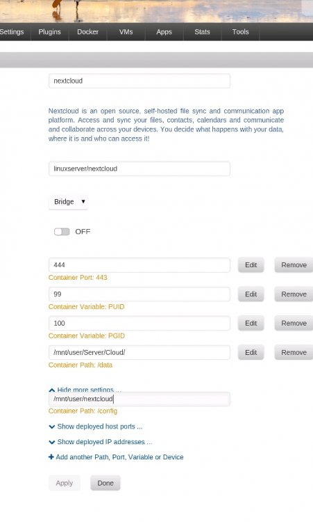

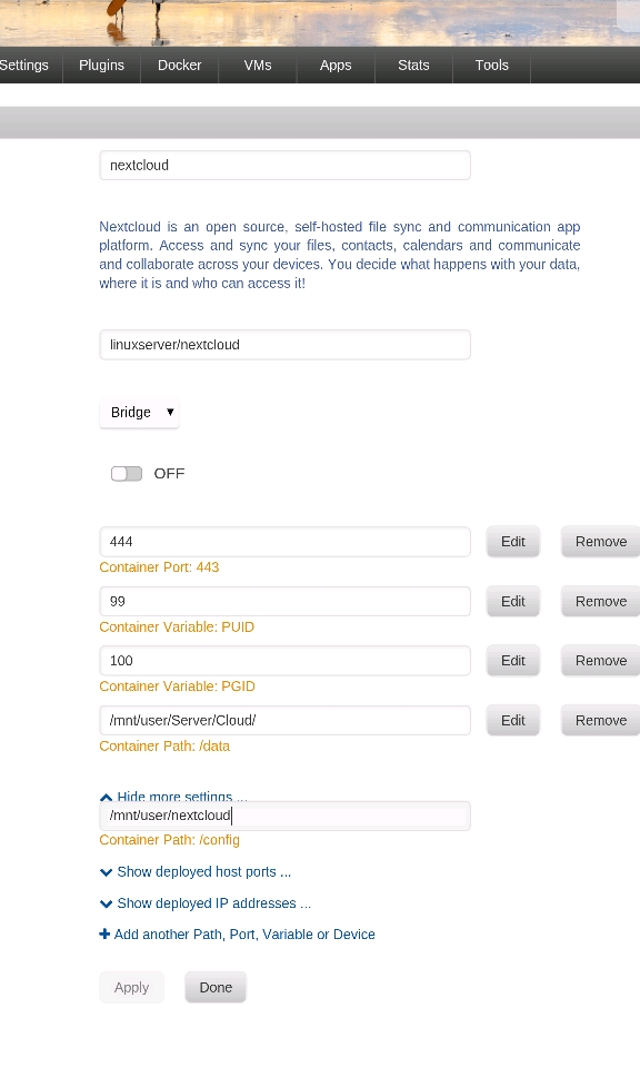

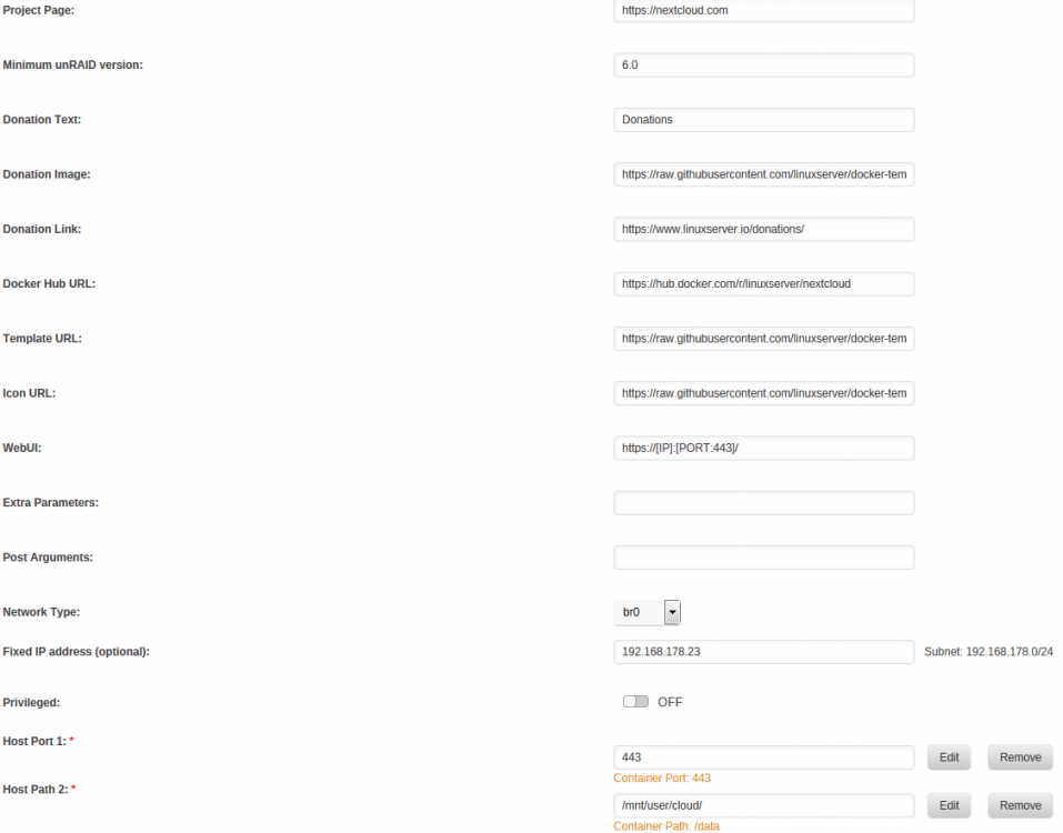

I am having an issue with this error:
Error
Your data directory is readable by other users
Please change the permissions to 0770 so that the directory cannot be listed by other users.
I am only testing UnRaid, and so I have my current NAS mounted to:
/mnt/disks/Nextcloud
via the Unassigned Devices plugin, and it's mounted as an SMB share. So far all of my other Dockers run just fine.
My SMB share settings in Unassigned Devices is set to:
Yes (Hidden)
Read/Write
The permissions are set as 0777 by default when mounted.
After much digging it seems this is a security warning from Nextcloud that I cannot disable, and I cant use the software without changing the permissions to the drive.
However, chmod does not work and gives no error, as if it ran the command just fine, bit the permissions are unchanged).
Editing various .cfg files (unassigned.devices.cfg, samba_mount.cfg, smb-extra.conf, etc) to include "create mask = 0770" has not helped, and the change gets removed if the drive is dismounted/re-mounted.
I've tried adjusting the Nextcloud container to mount the /data dir as R/W Slave, privileged, etc, all to no avail.
I followed the guide in OP to go through the setup process up until "Finish Setup" portion, at which point to restarted as it's supposed to and gave me this error.

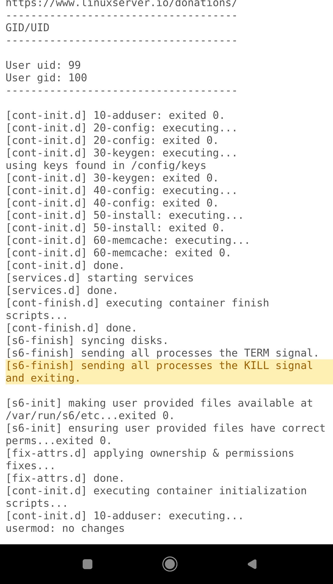

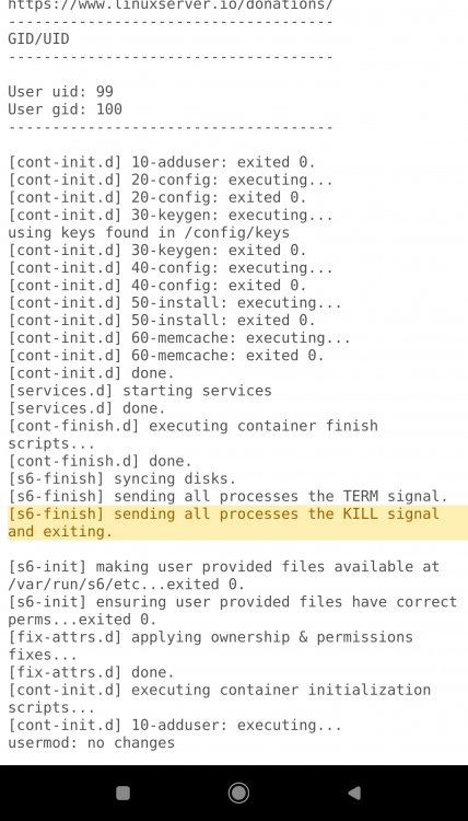

Hi, i am new to unraid 6. 4.1  and ask you for help today i update nextcloud 13 via web page says version 13.1 i think and the update  stop somewhere at 3,4,5, steps i think after downloading and then my nextcloud went to maintaince mode. How i can stop this mode. I try to uninstall container and image and reinstall it and same problem. Screenshots from Mariadb and Nextcloud log files.
Edited by Vesko
screenshot
Use the command line mode linked in the first post.

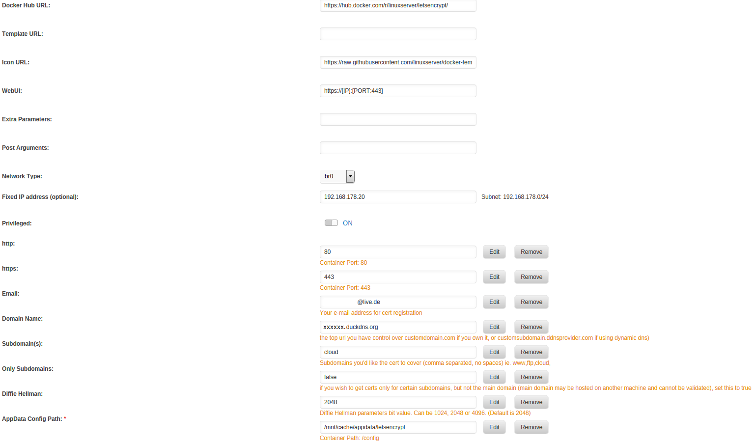

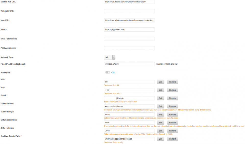

I am using nextcloud with letsencrypt docker without a problem with the bridged adapter.
However I would like to set a fixed IP address for both dockers in order to use the default ports 80 and 443 (see attachments):
Setting the fixed IP for letsencrypt worked fine, the default web page is available.
But setting the fixed IP for nextcloud resolves to HTTP error (status 500), even when accessing over local IP.
I have altered the trusted domain from my unraid ip to the new fixed ip (see below):

I have altered the proxy_pass in letsencrypt to the new fixed ip:
# listening on port 80 disabled by default, remove the "#" signs to enable
# redirect all traffic to https
#server {
#	listen 80;
#	server_name _;
#	return 301 https://$host$request_uri;
# main server block
server {
	listen 443 ssl http2;
	server_name cloud.xxxxxxx.duckdns.org;
	root /config/www;
	index index.html index.htm index.php;
	ssl_certificate /config/keys/letsencrypt/fullchain.pem;
	ssl_certificate_key /config/keys/letsencrypt/privkey.pem;
	ssl_dhparam /config/nginx/dhparams.pem;
	ssl_ciphers 'ECDHE-RSA-AES128-GCM-SHA256:ECDHE-ECDSA-AES128-GCM-SHA256:ECDHE-RSA-AES256-GCM-SHA384:ECDHE-ECDSA-AES256-GCM-SHA384:DHE-RSA-AES128-GCM-SHA256:DHE-DSS-AES128-GCM-SHA256:kEDH+AESGCM:ECDHE-RSA-AES128-SHA256:ECDHE-ECDSA-AES128-SHA256:ECDHE-RSA-AES128-SHA:ECDHE-ECDSA-AES128-SHA:ECDHE-RSA-AES256-SHA384:ECDHE-ECDSA-AES256-SHA384:ECDHE-RSA-AES256-SHA:ECDHE-ECDSA-AES256-SHA:DHE-RSA-AES128-SHA256:DHE-RSA-AES128-SHA:DHE-DSS-AES128-SHA256:DHE-RSA-AES256-SHA256:DHE-DSS-AES256-SHA:DHE-RSA-AES256-SHA:AES128-GCM-SHA256:AES256-GCM-SHA384:AES128-SHA256:AES256-SHA256:AES128-SHA:AES256-SHA:AES:CAMELLIA:DES-CBC3-SHA:!aNULL:!eNULL:!EXPORT:!DES:!RC4:!MD5:!PSK:!aECDH:!EDH-DSS-DES-CBC3-SHA:!EDH-RSA-DES-CBC3-SHA:!KRB5-DES-CBC3-SHA';
	###Extra Settings###
	ssl_prefer_server_ciphers on;
	ssl_session_cache shared:SSL:10m;
	### Add HTTP Strict Transport Security ###
	add_header Strict-Transport-Security "max-age=63072000; includeSubdomains";
	add_header Front-End-Https on;
	client_max_body_size 0;
	location / {
		include /config/nginx/proxy.conf;
		proxy_max_temp_file_size 2048m;
		proxy_pass https://192.168.178.23/;
I have not touched "cache/appdata/nextcloud/ngix/site-confs/".
Is there any cache or certs inside the nextcloud docker, which prevents the chage of the IP address?
Solution:
The MariaDB docker have to get also an fixed IP address, otherwise the nextcloud docker will not find it.
Somehow the were no errors in logs, because of that...
