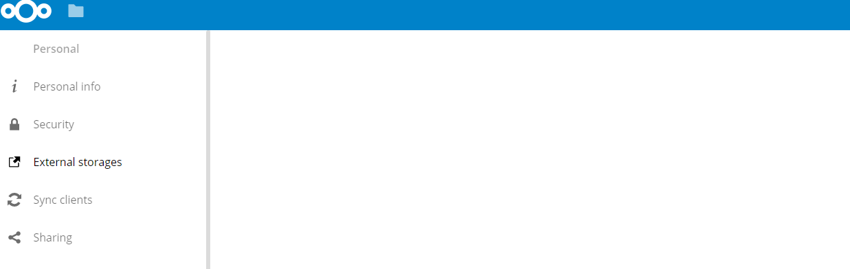

I've got a strange problem with external storage. After I enable the plugin, I'm unable to access the settings page ...../index.php/settings/user/externalstorages
For less than a second it shows up and after that it disappears.
Any help is appreciated.
