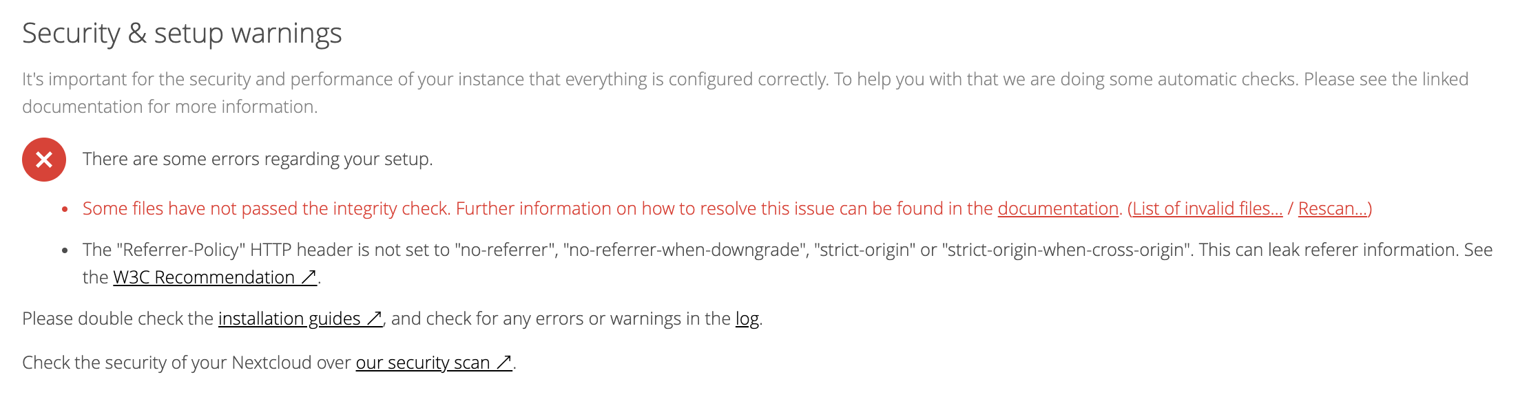

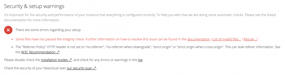

Hello.  I've bypassed my problem with - ._.DS_Store file, deleted it, and the error disappeared.  Now, I have a new warning.
There are some warnings regarding your setup.
The "Referrer-Policy" HTTP header is not set to "no-referrer", "no-referrer-when-downgrade", "strict-origin" or "strict-origin-when-cross-origin". This can leak referer information. See the W3C Recommendation ↗.
I don't know what folder and file to modify this?
