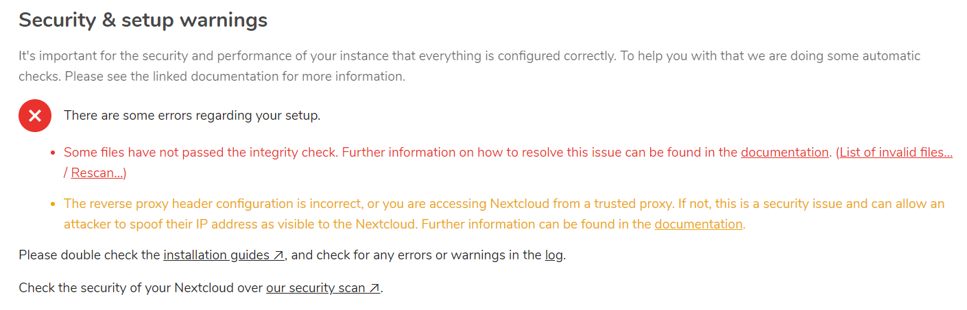

I have updated to V16 and now I'm getting this error
This is the list of invalid files, that I don't know where they are
Technical information
The following list covers which files have failed the integrity check. Please read the previous linked documentation to learn more about the errors and how to fix them.
Results
- files_rightclick
        - EXTRA_FILE
                 - README.md
Raw output
Array
    [files_rightclick] => Array
          [EXTRA_FILE] => Array
                [README.md] => Array
                           [expected] =>
                              [current] => cf73849388838de5037624e53303618579b164ec69fd55834ce4c5332ae33f778839e36298cbcc8ede90620927e076dbb8883479754e4c09b0491b15bf7653f3

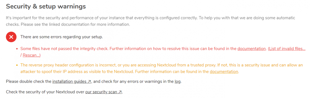

Results
- files_rightclick
        - EXTRA_FILE
                 - README.md
Raw output
Array
                           [expected] =>
Okay I fixed the first part. According to the file, the README.md is supposed to be empty and it has some information (doesn't make sense)
But Now I need help with the part of the reverse proxy header
For the warning relating the reverse proxy.
I was missing this line in the config.php for nextcloud
 'trusted_proxies' => ['letsencrypt'],
I took this from the template from let's encrypt
