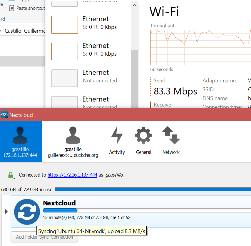

Maybe this has been asked before but I'm having a small situation with my nextcloud. It works fine, but I noticed the upload speed when I'm locally in the network is slow. Feels like using the internet bandwidth (About 40Mbps), instead of using my local network (1Gbps).
I did a small test using the nextcloud app to look at my IP of the docker, instead of my reverse proxy and it worked perfectly. Is there a workaround or anything for this?
I forgot.
In general, write performance is not fantastic. Data transfer speeds still depend on your configuration (share configuration, using cache, speed of cache, etc.) and there is database activity to process each file (lots of tiny files will result in more overhead vs. a few large files). I haven't measured the performance overall of writing to my NC app, but it's definitely slower compared to simply copying the data from my local system to a share over the network (also 1Gb network here).
How do I update a version of nextcloud?
Oh yes. That I understand. But I tried directly connecting to the nextcloud server via IP local and it would work way faster. But using the reverseproxy (inside my network too) would be half the speed.

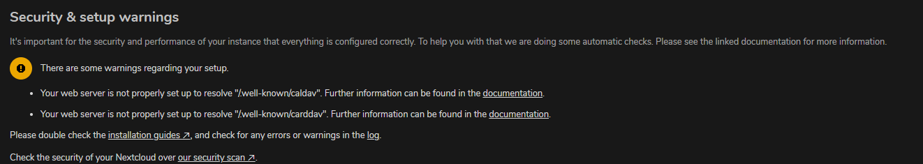

I am also having an issue with not setting up caldav/carddav. I've tried searching through the thread and I've added this code to appdata\letsencrypt\nginx\site-confs\default but it's still giving me the error. I've also tried adding the same code to my nextcloud\nginx\site-config\default and it's not working either. Anyone have an idea on how to fix this issue?
	location = /.well-known/carddav {
		return 301 $scheme://$host/remote.php/dav;
	location = /.well-known/caldav {
EDIT: I have fixed this issue! for anyone else who is having this error and is using YOURDOMAIN.COM/nextcloud as the URL you need to change it to this code. Very silly mistake of me but I'm glad all issues are resolved now :)
		return 301 $scheme://$host/nextcloud/remote.php/dav;
Edited by bobokun
