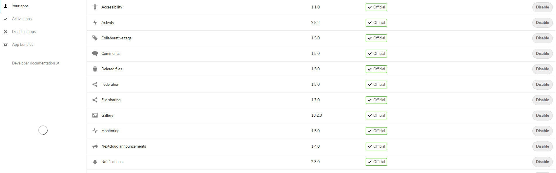

So I have nextcloud setup behind letsencyrpt reverse proxy per Space Invaders Video.  I can get into nextcloud and all that, but it seems I am unable to add any applications.  I just get a spinning wheel in the left pain under developer documentation.  Any ideas?  I would like to get this fully functional to start using it to sync photos and such with my phone and not use any other "cloud" storage options.

@InfInIty
I cant say for certain it's your issue, but I had a similar complication on an ubuntu server where I had used 255.0.0.0 as dns when making the ip static. Turns out it had to be 255.255.255.0
To get the apps added there's a workaround, which is to manually download them from the github and then adding the folder to the nextcloud/html/apps folder.
Once you add them you can go back to the gui and enable them.

I can look into side loading apps, but I would really prefer to get this working properly.
Mine is in a docker container, pointing to a MariaDB docker, all behind a Letsencrypt reverse proxy docker.

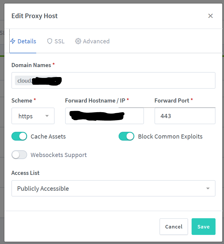

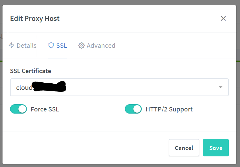

I can't say for sure what your issue is because I used Nginx Proxy Manager to get nextcloud up and running.
Perhaps you would have better luck using that?
I tried to follow the instructions per spaceinvaderone's video and it did not work for me.
