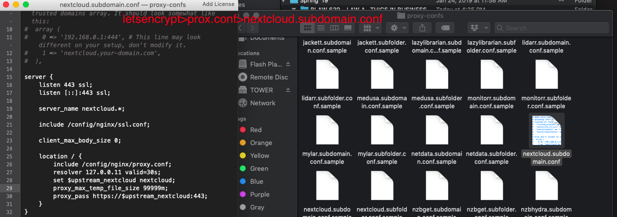

So I am getting an error (error 413) from the iOS app when I try to upload a video over 100Mb. Its this issue:
https://github.com/nextcloud/ios/issues/396
I am using this NC container with the LSIO letsencrypt container as well. I am trying to find an error log to see what the issue but all the logs I am looking at in both cases don't show any issues. Would I be right in saying that this NC container doesn't use Apache at all?
My Nextcloud is very slow
There is nothing in the Nextcloud-Log. What can i do to speed up my nextcloud?

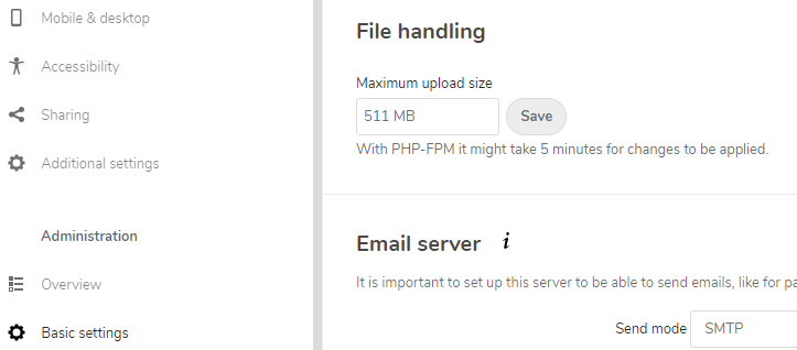

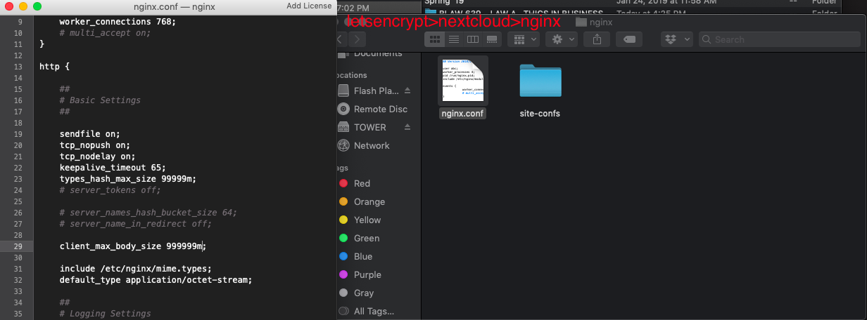

This happened to me. Go to the let's encrypt folder, then to the proxy folder and find the configuration for nextcloud subdomain.
There's an option that clearly puts the limit for download and upload. I set it to a high number.
Also check in the options for the nextcloud i believe there's a setting for maximum size uploads.
Sent from my Pixel 2 XL using Tapatalk

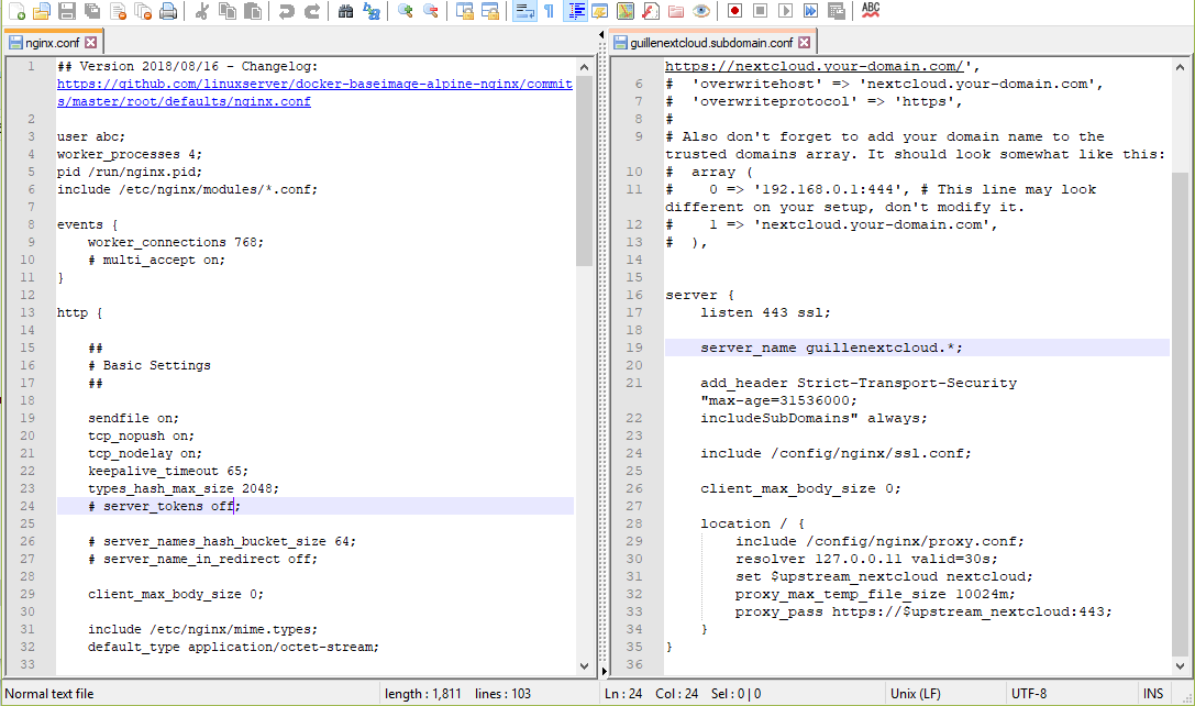

On 1/2/2019 at 4:26 PM, gacpac said:
I think I found a solution
Inside of the let's encrypt conf file for nextcloud I found
    location / {
        include /config/nginx/proxy.conf;
        resolver 127.0.0.11 valid=30s;
        set $upstream_nextcloud nextcloud;
        proxy_max_temp_file_size 2048m;
        proxy_pass https://$upstream_nextcloud:443;
Which makes sense why my files stop at 2GB. I'll give it a try and check again
Appreciate the reply but this didn't seem to have worked for me. I edited this file:
/mnt/user/appdata/letsencrypt/nginx/site-confs/nextcloud
server {
        listen 443 ssl;
        server_name box.dimtar.net;
        root /config/www;
        index index.html index.htm index.php;
        ###SSL Certificates
        ssl_certificate /config/keys/letsencrypt/fullchain.pem;
        ssl_certificate_key /config/keys/letsencrypt/privkey.pem;
        ###Diffie–Hellman key exchange ###
        ssl_dhparam /config/nginx/dhparams.pem;
        ###SSL Ciphers
        ssl_ciphers 'ECDHE-RSA-AES128-GCM-SHA256:ECDHE-ECDSA-AES128-GCM-SHA256:ECDHE-RSA-AES256-GCM-SHA384:ECDHE-ECDSA-AES256-GCM-SHA384:DHE-RSA-AES128-GCM-SHA256:DHE-DSS-AES128-GCM-SHA256:kEDH+AESGCM:ECDHE-RSA-AES128-SHA256:ECDHE-ECDSA-AES128-SHA256:ECDHE-RSA-AES128-SHA:ECDHE-ECDSA-AES128-SHA:ECDHE-RSA-AES256-SHA3$
        ###Extra Settings###
        ssl_prefer_server_ciphers on;
#       ssl_session_cache shared:SSL:10m;
        ### Add HTTP Strict Transport Security ###
        add_header Strict-Transport-Security "max-age=63072000; includeSubdomains";
        add_header Front-End-Https on;
        client_max_body_size 0;
        location / {
                proxy_pass https://192.168.1.2:444/;
        proxy_max_temp_file_size 8192m;

Have you checked in the website of nextcloud for this?
I have yes, its been set to 10GB since install.
