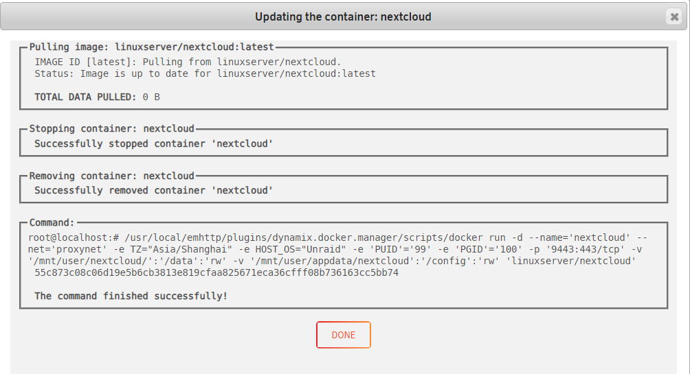

Hello, I see people mentioning nextcloud 15.0.5. My docker container recently shows upgrade for this nextcloud a couple of times. But after the upgrade I see I still at 14.0.3. May I know how to upgrade to 15.0.5 as your guys?
Thanks!
The docker container I always keep up to date and from time to time I check nextcloud with an admin account if any update is available. 15.05 I got a couple days ago, hit the update button, done. No special procedure. Check for an update with an Admin account in the settings section "overview", download it and install it. If everything works, the updater shouldn't show any errors. If you have issues, post the output of the updater. @rowid_alex
Thanks. I just got the update this evening so this time I tried to use "force update" function in advanced view to update the nextcloud container and the updater said it is up-to-date. So nothing is changed. I am still in 14.0.3 however...

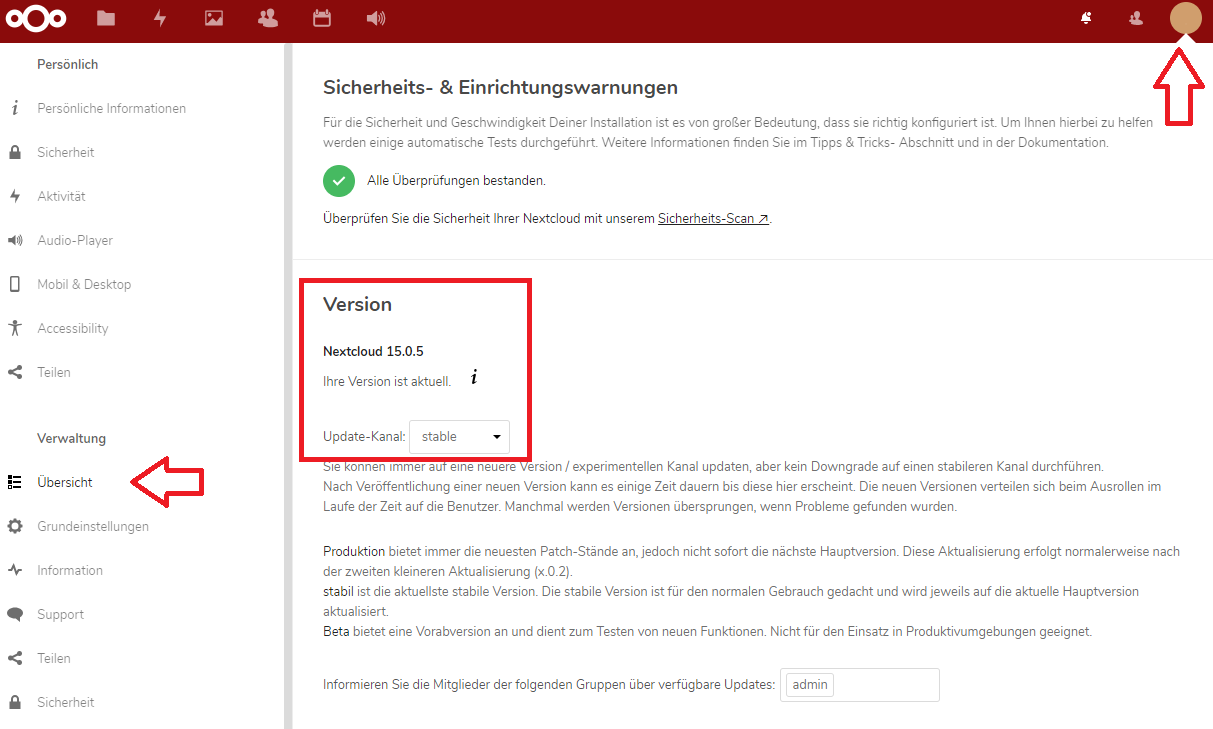

@rowid_alex Go to your nextcloud webinterface and as said earlier, login with an admin account and check if an update is available. It should show your current version and available updates. The nextcloud itself has to be updated inside the container.
Übersicht = overview or whatever language you are using.
Thanks! I thought this will be updated via docker container. I successfully upgraded to 15.0.5 now.
Not every software inside a docker is updated by the docker itself. It depends on how the docker is put together.
Learned this the hard way

Regarding your nextcloud it seems like you are running another docker on port 443. So you can change the port on Nextcloud or on the other docker.
