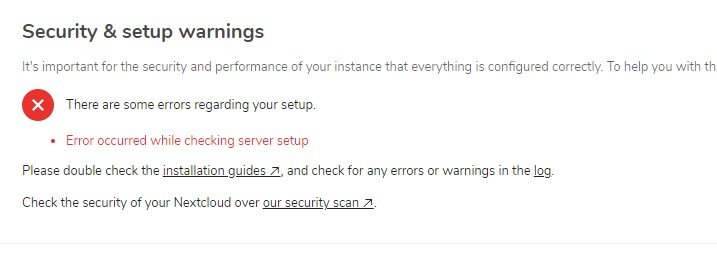

Does anybody have any idea why I am getting this message after upgrading MariaDB 10.3.15 today? Was running Nextcloud 15. Updated to the latest Nextcloud 16, the same error "Error occurred while checking server setup" is still persisting.
edit:
It had nothing to do with my setup or Maria DB. Checked the logs after, it turns out the Nextcloud.com was down. And that was causing the issues. Because part of the security scan is an online connection to their servers. All good Now!
Edited by pervin_1
