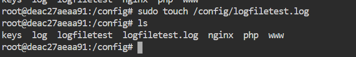

    After tinkering with this for a while, it seems the solution is much simpler than I thought. For some reason, the only step required is to modify the config.php file. No need to install ffmp

1 minute ago, CHBMB said:
I know that sudo -u abc works the issue is the damned forum sometimes adds invisible characters to text copied and pasted from it.
Sent from my Mi A1 using Tapatalk
@OOmatrixOO please type the command, don't copy and paste
FWIW I know it'll work as I was the one that added sudo to the container to allow us to run commands as the specified user from the command line so it would be possible to run occ as the same user that Nextcloud runs under.

2 hours ago, CHBMB said:
Type the command in manually, don't copy/paste I think this is probably the forum bug causing an issue.
If i type the command manually, then i have a new error 😞
root@567f1e60d30e:/# sudo -u abc touch /config/log/nextcloud.log
sudo: error in /etc/sudo.conf, line 0 while loading plugin "sudoers_policy"
sudo: /usr/lib/sudo/sudoers.so must be only be writable by owner
sudo: fatal error, unable to load plugins

PM sent, I dunno what you're doing, but something ain't right....

You're missing a very very important point here.  Containers are immutable, the container I run, is the same as the container you run, which is the same as the container @OOmatrixOO is running.  I think we both know he wouldn't know where to start with that link, and Ubuntu doesn't necessarily translate well to an Alpine docker container.
Instead I remoted in and just pulled a fresh container, typed the commands as I set out and it worked fine.
