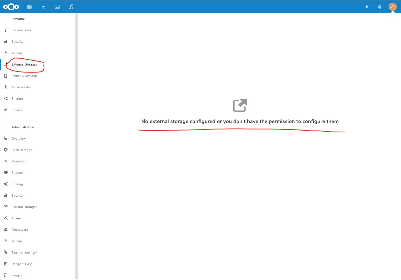

10 hours ago, emod said:
I tried, and I cannot change the setting ...see screen shot.
You need to configure them first. Select "External storages" further down in the admin part of the menu.

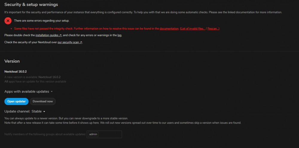

Anyone else get this error when updating the nextcloud to the latest version? 16.0.2
The documentation is there in the text, so probably better to click the link.
