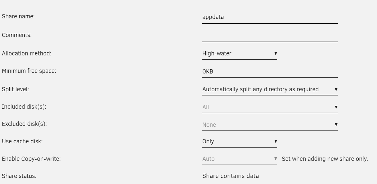

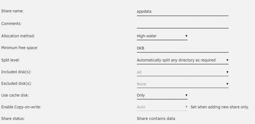

Actually that shows there is part of you log file on the array.
rm -rm /mnt/user0/appdata/nextcloud
Will remove it.  Probably need to check your appdata share to ensure it's set to prefer cache disk.
Edited by CHBMB
This is the appdata share:
And the command does not work for me:
root@Unraid:~# rm -rm /mnt/user0/appdata/nextcloud
rm: invalid option -- 'm'
Try 'rm --help' for more information.
Edited by OOmatrixOO
Well for whatever reason you DO have the logs directory on your array as /mnt/user0/ is the array minus the cache disk.
Apologies, typo in that command
rm -rf /mnt/user0/appdata/nextcloud
And @OOmatrixOO stop trying to do two fixes synchronously, you'll complicate matters more and you're making changes to things you don't understand.
As I said change Use cache disk to prefer.
Ok yes you are right sorry.
I typo in that command and now changed use cache to prefer.
