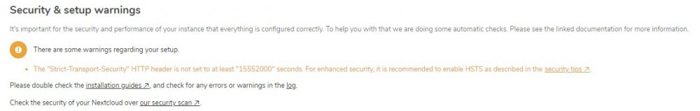

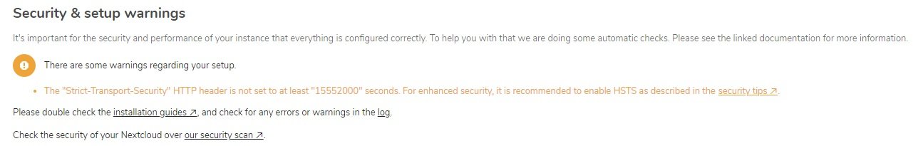

Hi All,
I have a new install of Nextcloud up and running. Thanks to loads of info on here I have been "cleaning up" a bit.  I have one security Issue I'm having trouble with.
My understanding is that I need to add the lines:
add_header Strict-Transport-Security "max-age=63072000; includeSubdomains";
add_header Front-End-Https on;
Into my  letsencrypt/nginx/proxy-config/Nextcloud.subdomain.config?   When I do I get a 502 bad gateway error.
Anyone have advise on how to resolve?
