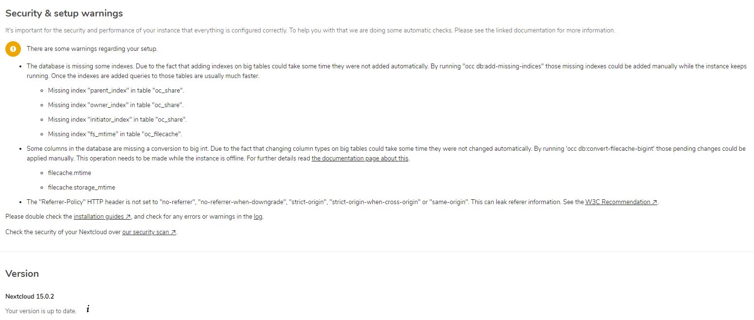

Sorry to bother, I did try searching for this and found others with the issue but not a resolution.
I had 13.0.0 installed, updated to 14.x and then 15.0.2 after that - all via WebUI and that went very smoothly.
I just now have these warnings, before the upgrades I didn't have any warnings or issues here listed, I also still continue to get an A+ rating on the Nextcloud security scan, but I would like to resolve all of these issues listed here for good measure.
EDIT - got the tables updated w/ the sudo -u -abc command in the docker shell, but still not sure why the refer-policy is kicking that back, i had thought i had that issue on 13.x originally and fixed it. I'll have to look around some more, but if someone has a link or info handy feel free to send it my way!
Any help is appreciated!

Ok, so far I am still really struggling with this error.
The "Referrer-Policy" HTTP header is not set to "no-referrer", "no-referrer-when-downgrade", "strict-origin", "strict-origin-when-cross-origin" or "same-origin".
I have searched around and found that the setup I followed had me put this in my reverse proxy (LetsEncrypt container) in my nextcloud site-config.
### Add HTTP Strict Transport Security ###
add_header Strict-Transport-Security "max-age=63072000; includeSubdomains";
Reasoning behind this I guess is that Nextcloud's own NGINX will issue those headers now after the update, and having them both cancels them out.
I've tried removing that from my LetsEncrypt site config and restarting both containers and no dice, the error still shows up.
Not sure what I'm doing wrong here - the post I initailly followed to set this all up is here: https://blog.linuxserver.io/2017/05/10/installing-nextcloud-on-unraid-with-letsencrypt-reverse-proxy/
Link to comment

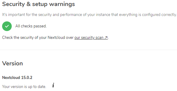

Well I did end up fixing this, but not in a way that I found many answers for, but this works and still gives me an A+ on the NextCloud security and I get the following in Nextcloud too!
All I did to fix this on my end was going into my LetsEncrypt site-conf for nextcloud, and under the ### Add HTTP Strict Transport Security ### section I added this header line.
add_header Referrer-Policy no-referrer;
After saving this and restarting LE and Nextcloud and re-checking, all checks pass and I'm getting an A+ on the security check!

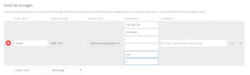

Hi, is it possible to use the "External Storage" plugin to map and access my Unraid share through Nextcloud?  Based on comments in this thread it would appear this is possible however I haven't had any luck getting this to work.
So far I’ve tried connecting as either SMB / CIFS with username/password and login - session. Also tried adding a “.” in for domain… no luck.
Has anyone gotten this to work?
P.S. Another option I'm thinking of trying is to map the shares to the docker container and then try using local.
External storage works when you set the paths properly. It threw me for a small loop when I first set it up, but I use it without issue.
Link to comment

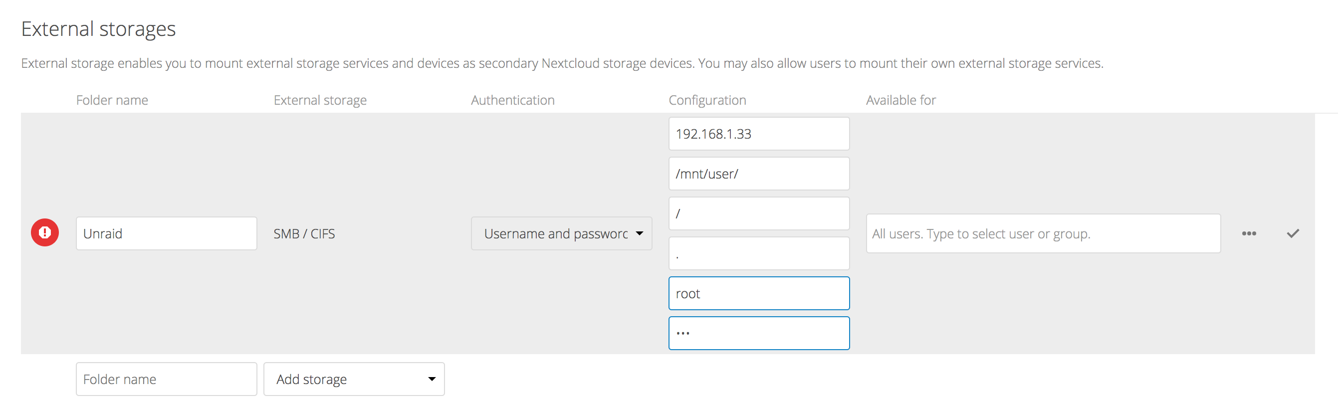

Any tips you can share on how to set it up :)
Ive tried numerous combinatorics... basically just looking to access either a specific share or the entire /mnt/user/ folder.
Link to comment
As this is external storage and nextcloud is accessing via SMB over network, the share must be accessible on the network (as set in Share settings).
Internal paths won't work, and I would personally create a non-root user to access those shares.
Assuming the share is exported to network, it should look like /media/ not /mnt/media/
