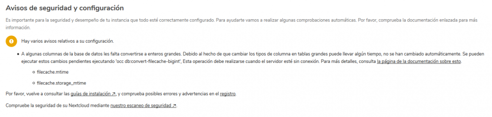

Can anyone help me with this, I have installed everyting following the instructions of Spaceinvaders video and error related to this
https://docs.nextcloud.com/server/15/admin_manual/configuration_database/bigint_identifiers.html
but when I execute this command in the nextcloud docker container I get this error
root@e8bafe322241:/$ sudo -u www-data ./occ db:convert-filecache-bigint
sudo: unknown user: www-data
sudo: unable to initialize policy plugin
how can I fix it? probably it's a complete noob error but I'm not very experienced yet with linux commands.
You can try using the abc user instead. There is no www-data user in out nextcloud container.
Programs run as abc--not www-data. Pretty sure you need to specify the PHP interpreter too. So, it should look like this:
sudo -u abc php /config/www/nextcloud/occ db:convert-filecache-bigint
  • Like 4
