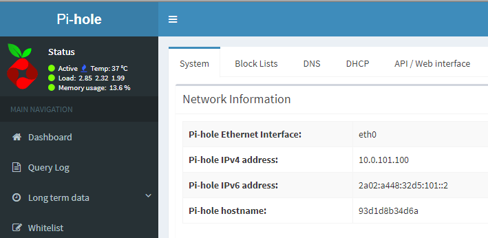

You need to have an IPv6 subnet and gateway defined on the interface which is used by the docker containers.
In my case I use a dedicated interface eth1 (br1) for container communications. Under network settings this interface is configured as IPv4+IPv6 without IP addresses assigned.
Next in my docker settings the IPv4 and IPv6 assignments are set manually:
If you use another interface or VLAN interface for docker containers, it should have similar settings manually set by you.
Docker does not allow communication between containers and host address (normal setup for eth0/br0), you should use a VLAN interface or dedicated interface to make this work.
I let the pihole container start as the very first container. Hence it will always get the next available IPv6 address in this range ::2. This address is configured as variable for pihole.
~# docker inspect Pi-hole
            "Networks": {
                "br1": {
                    "IPAMConfig": {
                        "IPv4Address": "10.0.101.100"
                    "Links": null,
                    "Aliases": [
                        "93d1d8b34d6a"
                    "NetworkID": "31b4aa8d663469b6218b5a3c39b9b84cddf26191c5198804c162b5ce7cf3c713",
                    "EndpointID": "f31c1cd39360650a2d204542292beeb9a346518a304f0b4f80e673027d31f769",
                    "Gateway": "10.0.101.1",
                    "IPAddress": "10.0.101.100",
                    "IPPrefixLen": 24,
                    "IPv6Gateway": "2a02:a448:32d5:101::1",
                    "GlobalIPv6Address": "2a02:a448:32d5:101::2",
                    "GlobalIPv6PrefixLen": 64,
                    "MacAddress": "02:42:0a:00:65:64",
                    "DriverOpts": null
Make sure your router has gateway address ::1 assigned. I am using a Ubiquiti USG router, see example below.

This is how pi-hole network settings look like

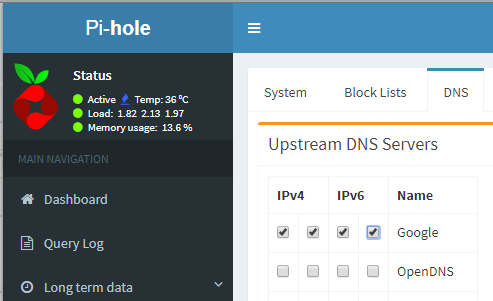

And you need to select IPv6 DNS servers, e.g. google
