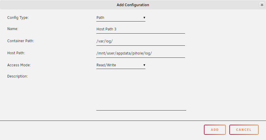

I've been running pihole on this docker for a few months. It works really well. Thanks for all your work on this. I am, however, running into a problem with the logs. The logs are going into /var/log/pihole inside the docker image. I can't see any way to change that; nor can I see any way to truncate the logs.I've read the first post, but don't see how I can do this as most of these instructions no longer seem to apply.
So, how can I clear my pihole logs on a schedule?
Again, thanks for all your work on this. It truly is a great tool!
I've never tried to change the log storage length so I'm not an expert.  I think you can edit the "pihole-FTL.conf" file in the appdata folder to set when things get flushed.  See link below.  You should look at the "MAXLOGAGE" setting and / or the "MAXDBDAYS" from the looks of things.
https://discourse.pi-hole.net/t/how-to-set-a-limit-to-log-file-length-to-maximum-used-log-file-space/6482
My understanding is that the logs are short term storage (default 24 hours stored in the image) and the database is long term storage (default 365 days stored in the appdata folder outside the image).
As for if you are concerned about the logs being stored inside the container image, you could maybe do the following to move the log storage out of the image.
Edited by FDM80
