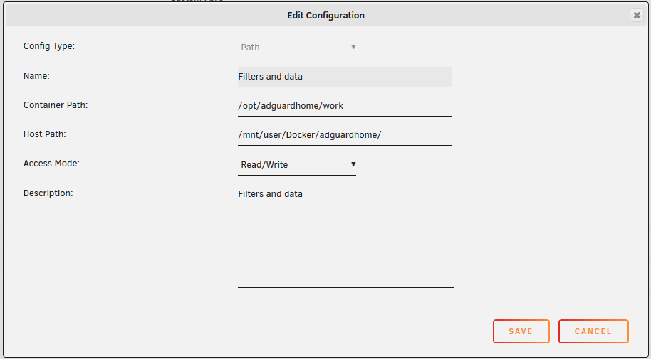

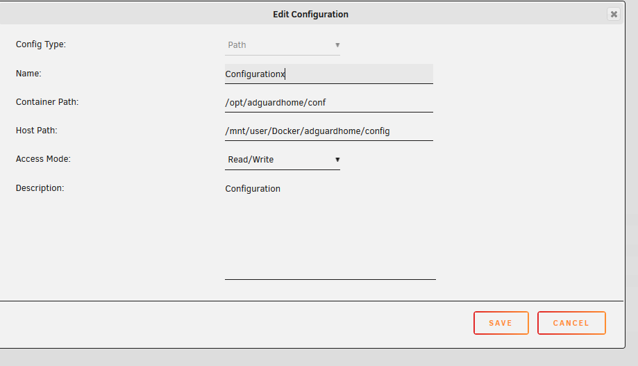

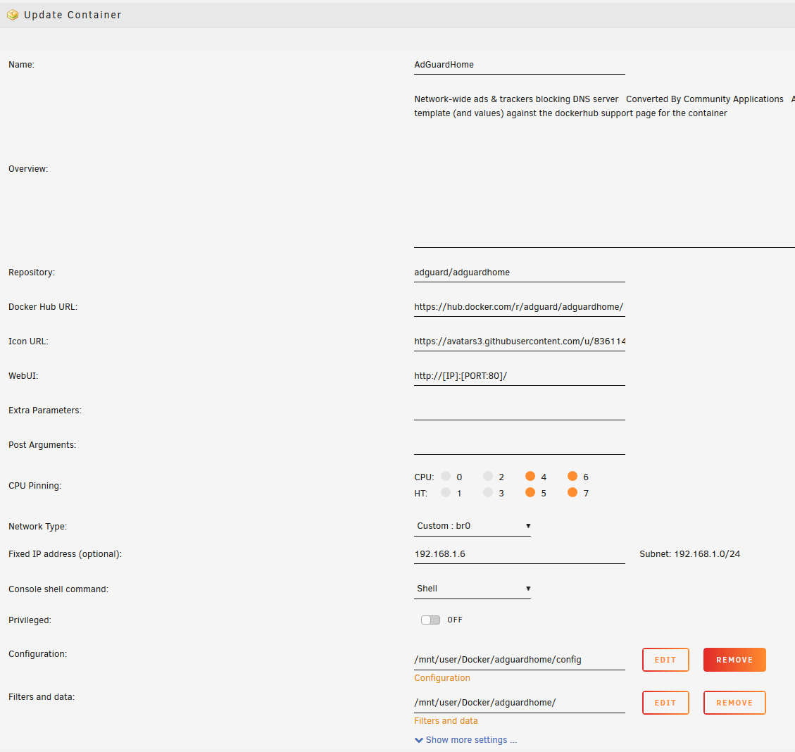

On 6/2/2019 at 7:20 PM, spants said:
Yes, the Linux server guys had a look at it. It just needs a template as the docker is already built (like pihole)
I am running it, it looks fine
Edited by L0rdRaiden
How did you get this into unraid docker?  I don't see it in Community Applications.
I took it from docker hub and configure it manually, if you copy my settings it will work
I don't know how to do the template to have it in unraid apps
How do I get it into unraid docker without using community apps?  Do I have to do it through terminal?
Do a search in community apps, then choose the option "Click Here To Get More Results From DockerHub"
Got it!  Thanks!  Seems to be working great!  I am wondering how to ad more filters?
