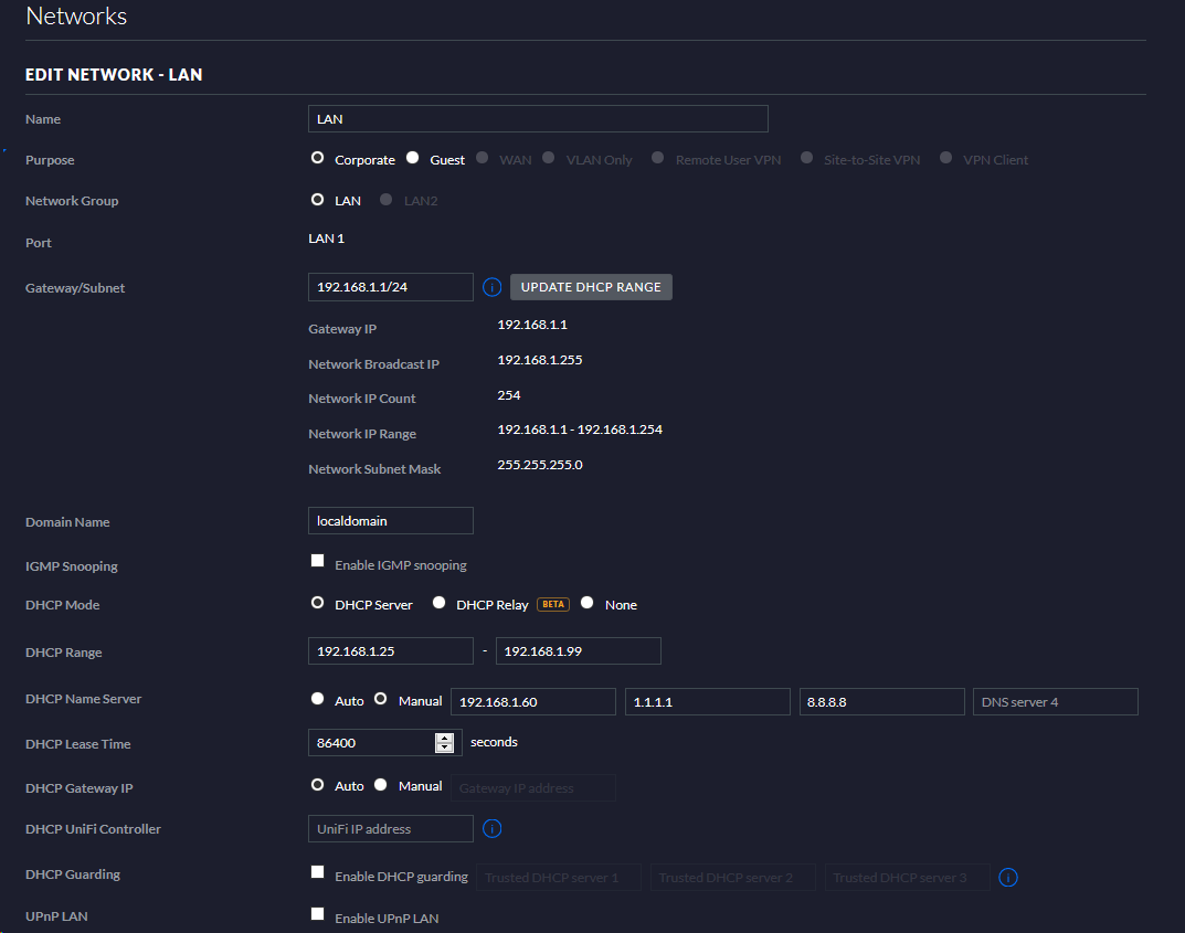

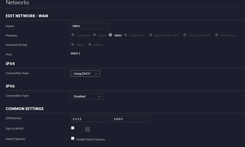

I have a different router (Ubiquiti USG), but, as an example, here are my settings:
WAN (router) DNS Server - I am also using Cloudflare DNS; this SHOULD NOT be set to the PiHole IP address:
LAN DHCP DNS (all my LANs have the same DNS settings) - Primary DNS is set to Pihole, secondary to Cloudflare, tertiary to Google - the last two are fallbacks in case there are problems with Pihole:
In my case Pihole is running on a Raspberry Pi to which a static IP address of 192.168.1.60 is assigned (I used to run it as a docker container in which case it was assigned a static IP address in unRAID - on an unRAID/router VLAN - but, not in the router config as a docker is not a separate device from the router point of view):
Here is what the config looks like in my Pihole docker (I still have it configured - but stopped - as a backup in case the Raspberry Pi had problems):

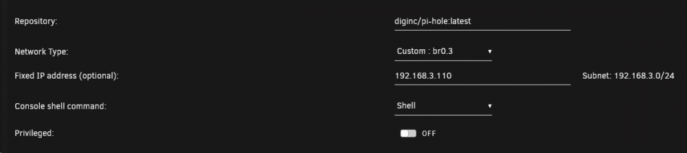

I have a custom VLAN setup in unRAID and my router for all dockers.

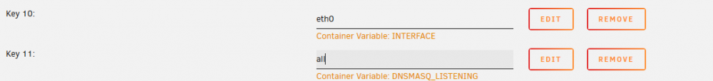

This is my config
Edited by L0rdRaiden
How can I make this the default setting after reboot? instead of permit all origins?
Do I have to change something here?
