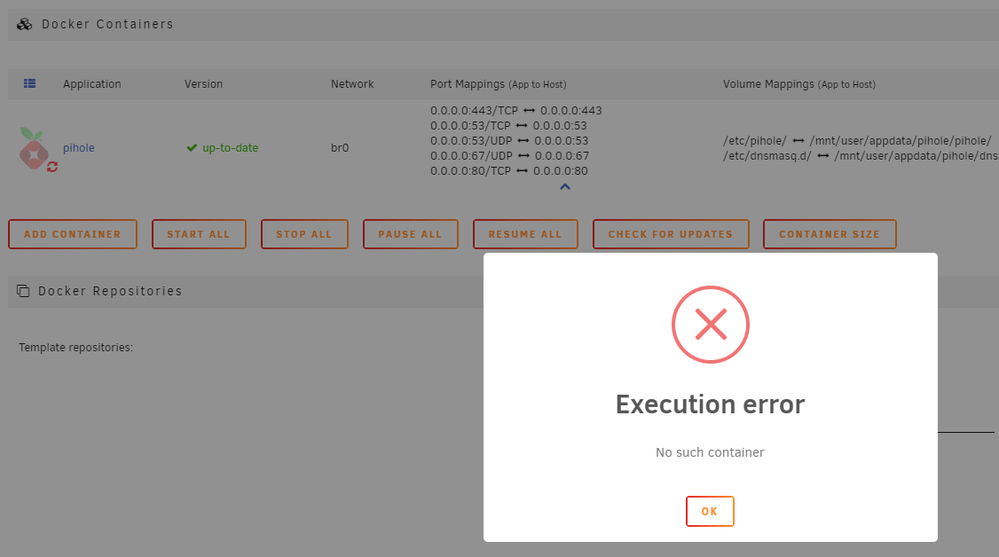

ran pihole fine for a day when I went to reset I got this:
Do I need to uninstall it and reinstall?
