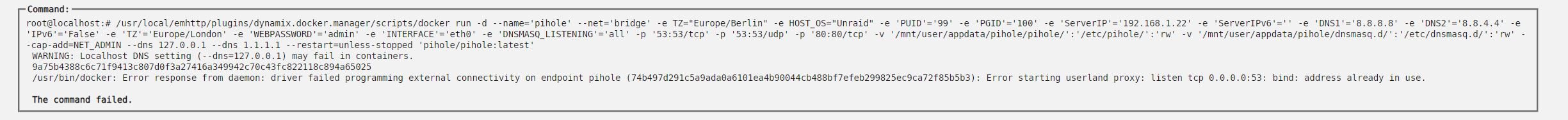

Can someone help me please. I get this error everytime i try to install pi-hole.
thanks in advance
