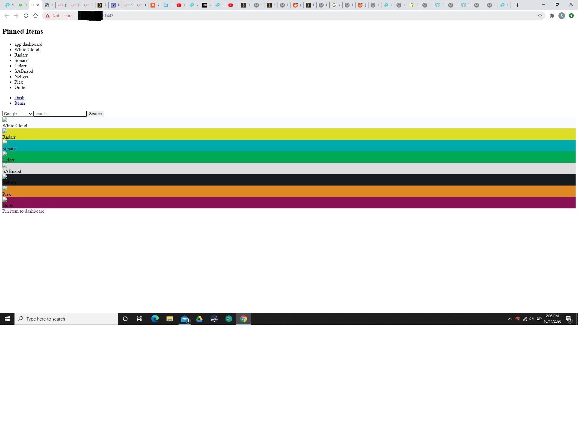

SPOautos Posted October 14, 2020 Share Posted October 14, 2020 (edited) My Swag GUI looks like this....it basically looks like data from my Heimdall app. Am I doing something wrong between the two? If this is messed up what would be the most likely cause? Edited October 14, 2020 by SPOautos Quote Link to comment
saarg Posted October 14, 2020 Share Posted October 14, 2020 16 hours ago, Mesias said: Hi there, I posted the problem I'm facing on the Unraid general support but I received no replies. I'm hoping I can get some feedback here. I changed from Letsencrypt to Swag recently and after the change i lose access to multiple sections in Unraid and all dockers stop functioning properly... I lose access thru the UI to the Dashboard, Docker and the bottom portion of the Main tab. The console gets unresponsive to any docker command and to the "powerdown" capability so every time I restart the system it has to do a parity check. Of course none of the apps using the reverse proxy are working to the outside. The migration was based on a fresh installation and I just copied the conf files from Letsecrypt. The Unraid logs show the following error (it varies depending on the page I'm trying): nginx: 2020/10/12 10:06:48 [error] 32315#32315: *246154 upstream timed out (110: Connection timed out) while reading response header from upstream, client ... upstream: "fastcgi://unix:/var/run/php5-fpm.sock" ... Any suggestion would be greatly appreciated. Please help! I don't see how swag can have anything to do with loosing access to parts of unraid. Turn off the container and see if it helps, if not, it has nothing to do with swag. If it helps, you have missconfigured something, but I do not know how you could manage that. Quote Link to comment
saarg Posted October 14, 2020 Share Posted October 14, 2020 1 hour ago, SPOautos said: My Swag GUI looks like this....it basically looks like data from my Heimdall app. Am I doing something wrong between the two? If this is messed up what would be the most likely cause? Swag doesn't have a GUI. Quote Link to comment
SPOautos Posted October 14, 2020 Share Posted October 14, 2020 Just now, saarg said: Swag doesn't have a GUI. okay, so its in the dropdown where you can select webgui but its not actually built in yet, correct? So is what I am seeing normal when I select on that webgui in the swag dropdown (for someone with Heimdall)? Quote Link to comment
saarg Posted October 14, 2020 Share Posted October 14, 2020 3 minutes ago, SPOautos said: okay, so its in the dropdown where you can select webgui but its not actually built in yet, correct? So is what I am seeing normal when I select on that webgui in the swag dropdown (for someone with Heimdall)? That goes to the default landing page of swag if you haven't changed it your self in the nginx default file. Nginx is the webserver. Have you added Heimdall to swag? You should post your docker run command. Quote Link to comment
SPOautos Posted October 14, 2020 Share Posted October 14, 2020 1 hour ago, saarg said: That goes to the default landing page of swag if you haven't changed it your self in the nginx default file. Nginx is the webserver. Have you added Heimdall to swag? You should post your docker run command. I have the Heimdall template network type pointing to the reverse proxy network and I have Heimdall listed but as "server" instead of Heimdall so that my url that pulls up Heimdall is server.myurl.com.....and it all functions perfectly except this one issue. How do I post my "docker run command"? Please forgive the ignorance but I'm brand new to all of this....."all of this" being computers, networks, servers, Unraid, all of it. I've been working on my server for about 2 months and just trying my best to learn everything as I go. A couple months ago I'd never heard of a reverse proxy, VPN, VM....nothing lol. So I'm about as newbie as they come....BUT slowly Im getting it all working great! If you can get me a little more info regarding the docker run command I'll post it and maybe we can figure out if I need to edit something in nginx. Quote Link to comment
saarg Posted October 15, 2020 Share Posted October 15, 2020 7 hours ago, SPOautos said: I have the Heimdall template network type pointing to the reverse proxy network and I have Heimdall listed but as "server" instead of Heimdall so that my url that pulls up Heimdall is server.myurl.com.....and it all functions perfectly except this one issue. How do I post my "docker run command"? Please forgive the ignorance but I'm brand new to all of this....."all of this" being computers, networks, servers, Unraid, all of it. I've been working on my server for about 2 months and just trying my best to learn everything as I go. A couple months ago I'd never heard of a reverse proxy, VPN, VM....nothing lol. So I'm about as newbie as they come....BUT slowly Im getting it all working great! If you can get me a little more info regarding the docker run command I'll post it and maybe we can figure out if I need to edit something in nginx. If you have set up nginx to serve Heimdall as the landing page, then it's no wonder that you get Heimdall when opening the webgui link in swag. Of you want help, the best way is to provide the config files you have changed stuff in. That way it's much easier for the ones helping. The docker run command is the command popping up when you update or change something in the container template. Just add something to a field and remove it, then hit apply and you will get the command. Quote Link to comment
SPOautos Posted October 15, 2020 Share Posted October 15, 2020 (edited) 17 hours ago, saarg said: If you have set up nginx to serve Heimdall as the landing page, then it's no wonder that you get Heimdall when opening the webgui link in swag. Of you want help, the best way is to provide the config files you have changed stuff in. That way it's much easier for the ones helping. The docker run command is the command popping up when you update or change something in the container template. Just add something to a field and remove it, then hit apply and you will get the command. Thank You! So this is the docker run command you were refering too, correct? I want sure if you meant the one for Swag or Heimdall so I just attached them both.... SWAG.... Command: root@localhost:# /usr/local/emhttp/plugins/dynamix.docker.manager/scripts/docker run -d --name='swag' --net='proxynet' -e TZ="America/Chicago" -e HOST_OS="Unraid" -e 'EMAIL'='[email protected]' -e 'URL'='mywebsite.com' -e 'SUBDOMAINS'='ombi,server,sonarr,radarr,lidarr,nextcloud,sabnzbd,nzbget,plex' -e 'ONLY_SUBDOMAINS'='true' -e 'VALIDATION'='http' -e 'DNSPLUGIN'='' -e 'EXTRA_DOMAINS'='' -e 'STAGING'='false' -e 'DUCKDNSTOKEN'='' -e 'PROPAGATION'='' -e 'PUID'='99' -e 'PGID'='100' -p '180:80/tcp' -p '1443:443/tcp' -v '/mnt/user/appdata/swag':'/config':'rw' --cap-add=NET_ADMIN 'linuxserver/swag' 76457241e9b946d99184a4254b3963fe78876f13c10d23e0fed380eb7a8ceb4e The command finished successfully! Heimdall..... Command:root@localhost:# /usr/local/emhttp/plugins/dynamix.docker.manager/scripts/docker run -d --name='heimdall' --net='proxynet' -e TZ="America/Chicago" -e HOST_OS="Unraid" -e 'PUID'='99' -e 'PGID'='100' -p '280:80/tcp' -p '2443:443/tcp' -v '/mnt/user/appdata/heimdall':'/config':'rw' 'linuxserver/heimdall' 773977f9c74aa209781671d43f3d93c6b6200b45132fc58ae73bc2f27b1402cb The command finished successfully! I went to appdata/Heimdall/nginix/site-confs/default but when I open it and highlight it all and copy, it wont let me paste it in here. What is the best way to provide the config files? Edited October 15, 2020 by SPOautos Quote Link to comment
