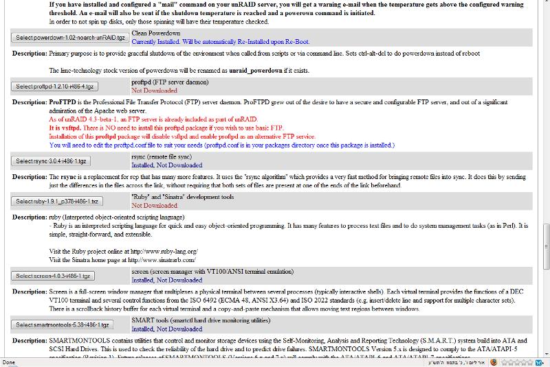

see attached picture of my packages menu.
It is clearly written "screen... Installed, Not Downloaded"
I don't remember downloading it because I only heard about it today - I have the server running for ~2 weeks now.
For example, something I did download and install is Clean Powerdown which also states: "Currently Installed. Will be automatically Re-Installed upon Re-Boot."
I don't think I am that forgetful...  :P
I'm sure that it is not included on 4.5.4 unrAID, you probably installed it. ??? ???
lets leave it a mystery ...  ???
I just rebooted to stock unRAID 4.5.4 and confirm that there is no screen in it.
Then either there is a bug with the indication (see my screen-shot above) or some other package installed it.
