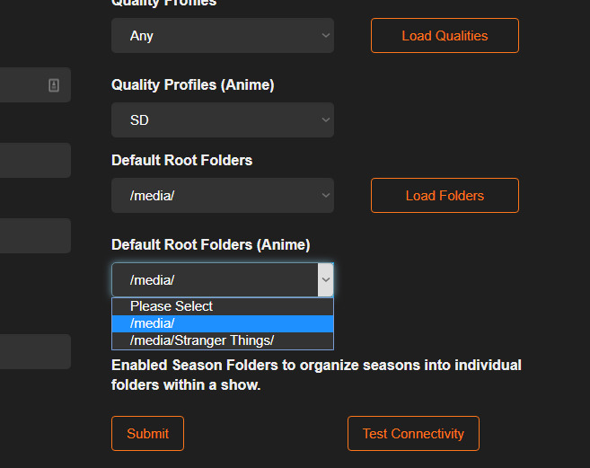

Having issues with Ombi showing folders that should not be used as root folders.  This is happening only in the sonarr section.  I use Radarr also, but the media folders are correct in Radarr.  This area was correct for a long time and working correctly.
Setup window for media folders in Sonarr:
Root folder area in Ombi for Sonarr:
I have uninstalled Ombi completely, and started over, but the same result occurs.  Any ideas on how to pull the correct path over for my secondary folder?
There is no automation when you map a folder to the container to get it selected in ombi. You have to set the root folder to /anime yourself.
Isn't it selected in default root folder?
This is coming from sonarr, you need to setup your root folders correctly in sonarr.

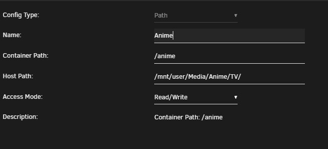

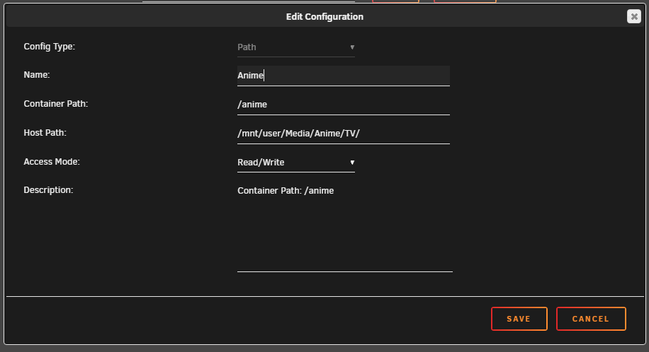

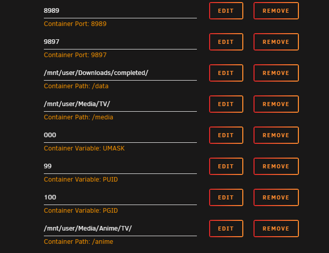

the top screen shot is from Sonarr.... but here is another of the full paths in SONARR.  If this is not an OMBI issue, just let me know and I will post over there....
and then the individual setup for the /anime path...  No mention of "Stranger Things"
I *think* @tidusjar meant the settings within Sonarr itself, not the docker settings for it.
thanks for the tip.  I compared Radarr settings to Sonarr settings in the apps, and I am not seeing any difference.  I thought that the paths were all set in the docker settings, which is how I have Radarr set up.
The docker settings only maps the unraid path to the container path. You also have to set up the paths inside the setting of the app. There is no automatic setup for that, it's all manual.
thanks again.  I really thought that when a request came in on Ombi, there was a dropdown for the approver (admin) to be able to choose at that point, what path to put the request in.  I  don't have a screen shot at this time, since I reinstalled the docker container and I don't have any requests quite yet.  thanks again though, I will take a look around and figure it out in time.
