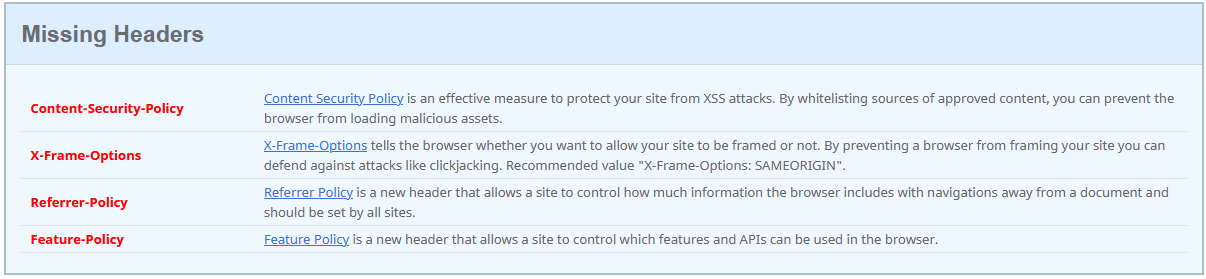

I guess these missing security headers are something for the Ombi dev to sort rather than LinuxServer.io?
This would actually be up to you and whichever reverse proxy method you use for the access of the container.
