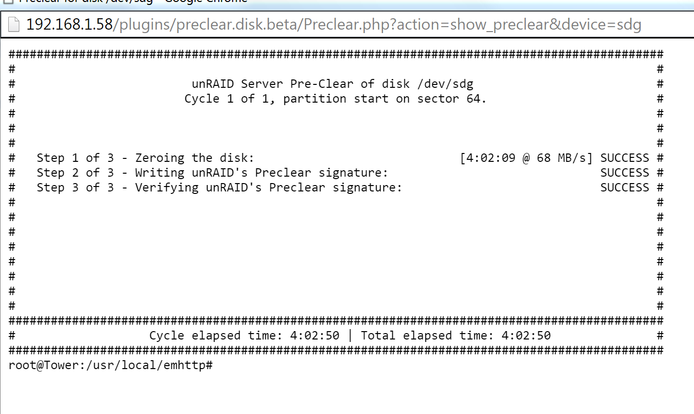

Just finished preclearing a 3TB WD Green, this disk was previously used on another server so skipped pre and post reads, but failed verifying signature:
Good to know it's not only me  :)
Thank you both for your testing! I just tested on <2TB disks, so it's likely something is wrong with larger disks. Well, the good part is that we know that verification part is working fine  ;D
I'll keep you posted when I got this fixed, ok?
Cheers.

#                         unRAID Server Pre-Clear of disk /dev/sdi                          #
#   Model Family:   Seagate Desktop HDD.15                                                  #
#   Device Model:   ST4000DM000-1F2168                                                      #
#   Serial Number:  S301HZ0B                                                                #
#   User Capacity:  4,000,787,030,016 bytes [4.00 TB]                                       #
#   Firmware:       CC54                                                                    #
#   Disk Device:    /dev/sdi                                                                #
#   Type Yes to proceed:                                                                    #
#                        Cycle 1 of 1, partition start on sector 64.                        #
#   Step 1 of 4 - Zeroing the disk:                                    [@ 140 MB/s] SUCCESS #
#   Step 2 of 4 - Writing unRAID's Preclear signature:                              SUCCESS #
#   Step 3 of 4 - Verifying unRAID's Preclear signature:                            SUCCESS #
#   Step 4 of 4 - Post-Read verification:                              [@ 135 MB/s] SUCCESS #
#                Cycle elapsed time: 16:06:17 | Total elapsed time: 16:06:17                #
The good news is that apparently I found that bug preventing >2TB disks to be precleared. Spent 16 hours for a 4TB disk, not bad. With a pre-read step, it would take 24 hours per cycle.
Plugin updated.

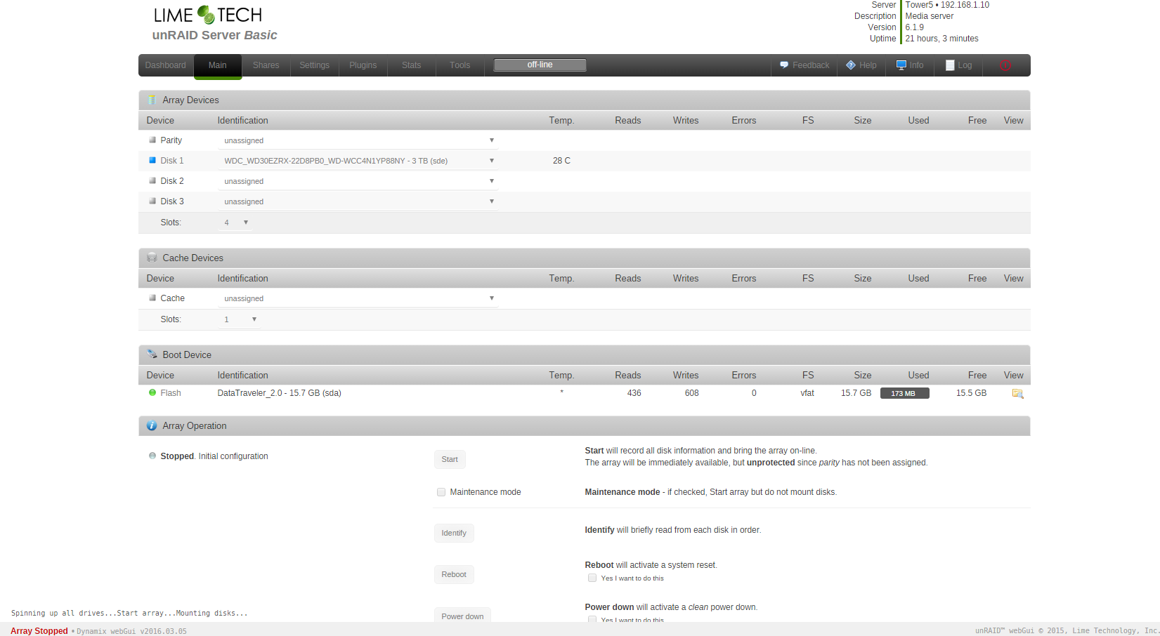

This server is preclearing 3 disks, I tried starting the array with a single disk to copy some data in the meantime and it's been like this for 2 hours.

You can only preclear unassigned disks, I'm preclearing 3 disks and trying to start the array with another disk.
