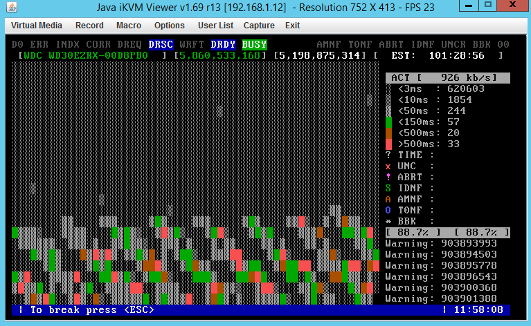

This program has a lot of caveats, like its output; there's no reliable way of retrieving the speed or how many blocks it had already read.
I'd really like to see an option to display slow sectors, I've been using MHDD, it's the first thing I do on any new disk, before preclear, any disk with abnormal slow sectors doesn't go in my servers, because in my experience these will turn to bad blocks sooner rather then later, and until that happens SMART looks perfect.
Also use it when I suspect a disk has developed some, e.g., parity check slows down considerably, unfortunately MHDD is not practical to run on server installed disks because it only works with onboard ports in IDE mode, doesn't work in AHCI or HBAs.
Here's an example of a recent one, WD Green 3TB, parity check took 3 more hours than usual, after identifying disk, had several zones with read speeds <1MB/s, replaced it and used it for a while on my test server, after 3 or 4 parity checks had a lot of pending sectors.
Perfect SMART report before it was replaced:

cool graphic cant say the advertising is something i want to see.
Sorry about that, I use adblocker so don't see them, post edited.

There's a linux clone, http://whdd.org/demo/, there's even a slackware package but it's 32bits.
While the graphic part of MHDD is pretty, what I really care about are the stats, below two examples of a good disk, and a bad one that at 4% scan has several slow sectors.
width=200http://s10.postimg.org/gjso76ort/2016_03_31_09_55_54.jpg[/img]
width=200http://s10.postimg.org/8guhvv46h/2016_03_31_16_59_10.jpg[/img]
Good disks usually have very few sectors >10ms, but it's normal to a handful of <150ms, on a healthy disk there shouldn't be any >150ms.
