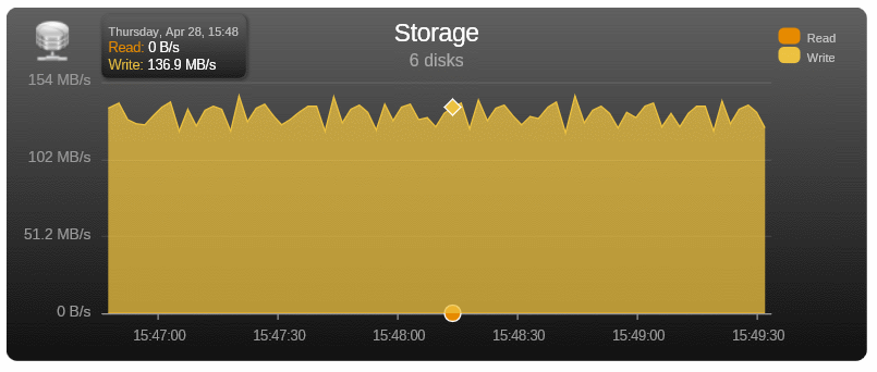

Just kicked off a Preclear of a new 8TB Seagate archive using the beta plugin... Will report back when it's done!
Not really a big deal but the speeds are not correct, write speed should be lower than the average as the disks goes to the inner tracks, they are always similar, it looks to me like the current write speed is the wrong one.
#                                        unRAID Server Pre-Clear of disk /dev/sdf                                          #
#                                       Cycle 1 of 1, partition start on sector 64.                                        #
#   Step 1 of 3 - Zeroing in progress:                                                                       (30% Done)    #
#   ** Time elapsed: 3:04:35 | Write speed: 166 MB/s | Average speed: 166 MB/s                                             #
#                                   Cycle elapsed time: 3:04:38 | Total elapsed time: 3:04:39                              #
Unless controller bottleneck is limiting the speed in the outer tracks.
Initial speed was 175MB/s, now @ 50%, disk write speed at this point is <150MB/s.

Write speed is obtained from dd output, and Average speed is calculated by dividing the written blocks by the elapsed time. Is common that they coincide until the very end of the disk, where the speed drop is more tangible.
I believe DD output is also average speed:
#   Step 1 of 3 - Zeroing in progress:                                                                       (58% Done)    #
#   ** Time elapsed: 6:19:25 | Write speed: 155 MB/s | Average speed: 154 MB/s                                             #
#                                 Cycle elapsed time: 6:19:29 | Total elapsed time: 6:19:29                                #
Current disk speed is <140MB/s
