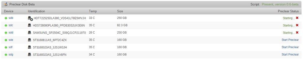

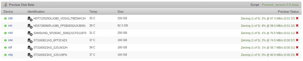

Just install this beta plugin @ my 6.2 beta23 server, it can run in the PLUS licence server but not in the TRIAL licence server. The web console just show "Starting", but in fact "dd" not running.
After some troubleshooting, it seems to be problem on "usr/bin/tmux"
root@Tower:/usr/bin# /usr/bin/tmux new-session -d -x 140 -y 200 -s preclear_disk_sdb
/usr/bin/tmux: error while loading shared libraries: libutempter.so.0: cannot open shared object file: No such file or directory
BTW, I can run preclear if execute script directly
/bin/bash /usr/local/emhttp/plugins/preclear.disk.beta/script/preclear_disk.sh --notify 1 --frequency 3 --cycles 5 --skip-preread --skip-postread --no-prompt /dev/sdb
Thanks
I reinstalled the old preclear plugin on a 6.2 beta23 trial server and it allows me to run a clear normally with the preclear beta plugin.
Thanks a lot for your report. Please update and try again. The running preclear sessions won't stop because of the update.
Just have update, it work now, thanks a lot.
