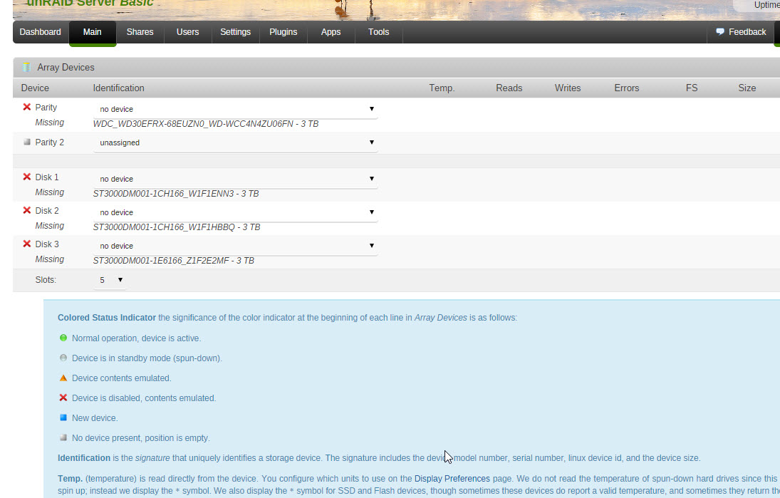

I do have a question. I have an array I had started with 3 disks and a parity drive. Has a single share with almost no data . I shut down the array and disabled all of them as shown in the attachment. However, none of them show up in my list of available disks to preclear?
Also, is a single cycle enough or should I being doing multiple? Thank you.
While the serial of that disk is registered in the super.dat file, you can't start a preclear on it. There are two solutions to preclear an array disk:
1) If you have a valid array, you can retire a disk by living its slot empty and then starting the array. Your disk serial will be erased from super.dat file and you can then start a preclear session;
2) If you want to preclear multiple array disks, you have to go to Tools > New Config and erase your super.dat file. This will result in your parity data being invalid, but if you want to erase multiple disks, that's inevitable.
As for your other question, I do run 3 cycles on my disks. The limit is 5 cycles, but you can start a new preclear after that. If you can wait some time, 5 cycles should be more than enough.
