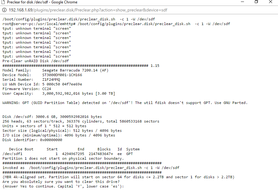

I have searched the forums and other people are finding this issue, I shall read further but when trying to run a preclear on another disk if I click the eye icon to view the progress I just get
tput: unknown terminal "screen"
etc,etc
I've noticed some people suggesting to use the original scripts but I don't get that option from the drop down when selecting preclear.
etc,etc
Getting the same thing.. Joe. L's works fine as suggested. Not all the options your building in though. Any idea? Looks like it running ok in the status on the pluggin, just the popup windows does not display the working stats.
