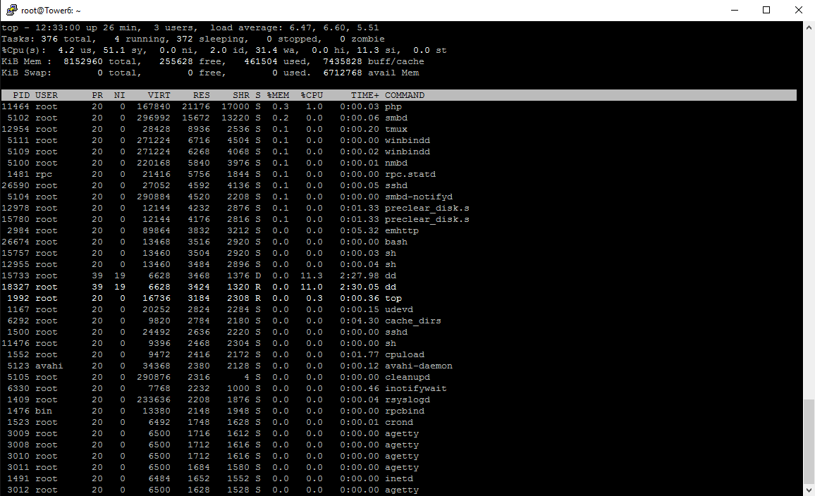

With the array running, I then started a single pre-clear while watching "top".  Memory utilization jumped from 8% to 15%.  Interestingly, I see multiple "preclear_+" processes.  There seems to be a main one, consuming 1.023GB within a few seconds of starting.
I was comparing your findings on one of my servers and it appears preclear beta uses much less RAM than on yours, I have the array started doing a dual disk upgrade and preclearing two disks at the same time, this server has 8GB of RAM.
EDIT: Just though of a reason that can explain the difference, since these are previously used disks I'm skipping the pre and post reads, so the pre read can have higher memory utilization than the zeroing.
That's very odd, how little memory the beta preclear is using on your system, and how much it is using on mine.  I'll run a zero only, skipping the pre/post reads, and see if that has an impact.

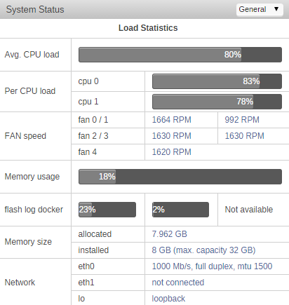

But, I have a different issue now. I just ran 2 simultaneous 5 cycle preclears in 15 minutes. The reason it was so fast is that it is only looking at 1gb of the 2tb. The only thing I did is choose the script and activate the fast post read. Tried it without the fast post read and it did the same thing. Normally I would think it was the drive but to have 2 drives with the exact same problem. Any help anyone can provide would be greatly appreciated.
Here is a screenshot of the log on a freshly started preclear.
Thanks for the info.
When switching to the Joe L. script(actually bjp999) I have the option for fast post read.
