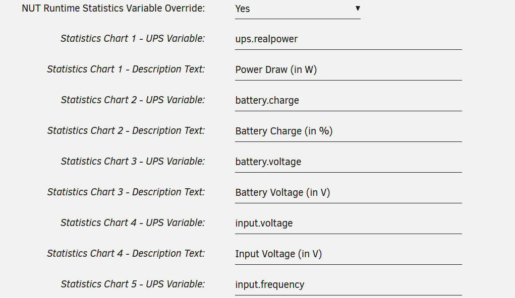

Just now, efisher said:
I think my problem is that ups.realpower is not provided via the UPS driver. My confusion is, if this isn't present in the driver, how is it showing up in the NUT Footer? Is that number calculated? If so, is it possible to do the same calculation in the statistics overrides?
At the moment the charts can only monitor variables that are actually reported by the UPS, not those calculated inside the GUI.
I guess many people use external charting solutions (Grafana, ...) with NUT, where you can do such more complex manipulations.
It may well be possible in the future at some point, but I can't provide a time-frame on that just yet, sorry.

So, to confirm, the NUT footer is indeed using a calculation, but NUT statistics can't use a calculation at this time. Is that correct?
Thanks for this reply, will look into graphana meanwhile.
Yes, that's correct, the charts receive the information straight from the backend and the calculation is done in the frontend for visuals.

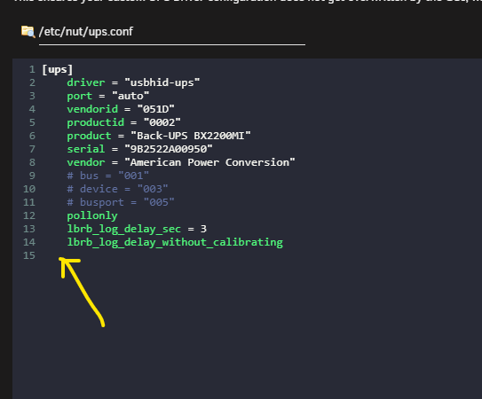

My previous UPS was replaced by the manufacturer because it alerted me that the batteries needed replacement. However, I installed the replacement unit, and it passed the test. But I'm still getting emails that my batteries need replacement. What to do? My UPS is APC Back-UPS BX2200MI
I tried clicking the "NUT Debug Package (.zip)" in NUT settings, but it doesn't do anything.
This is a known firmware issue with that series, please check out this pinned post for a solution:
https://forums.unraid.net/topic/60217-plugin-nut-v2-network-ups-tools/page/70/#comment-1494093
As for the debug package, it should open a download (see if your browser does not block it), but may take a while (~30 secs max) at that.
3 minutes ago, HHUBS said:
Ok, done with the steps.. Question, is this right or should I NOT indent it?
The parser does not care about whitespace between words. If you like to indent things with tabs or spaces, feel free to do it.

Hey everyone, I recently had to buy a new UPS. I decided on an "APC Back UPS BX – BX1200MI-GR."
Can anyone tell me why I keep getting these alerts? I didn't have that with my Green Cell UPS...
Thanks
nut-ups.dev nut-debug-20250816133125.zip
Thanks
It's a known firmware issue with that series, please check this post for how to fix it:
ah okay i have changed to preview build, but the changes in ups.conf aren't saved. I'll wait a night and see if the alerts continue.
