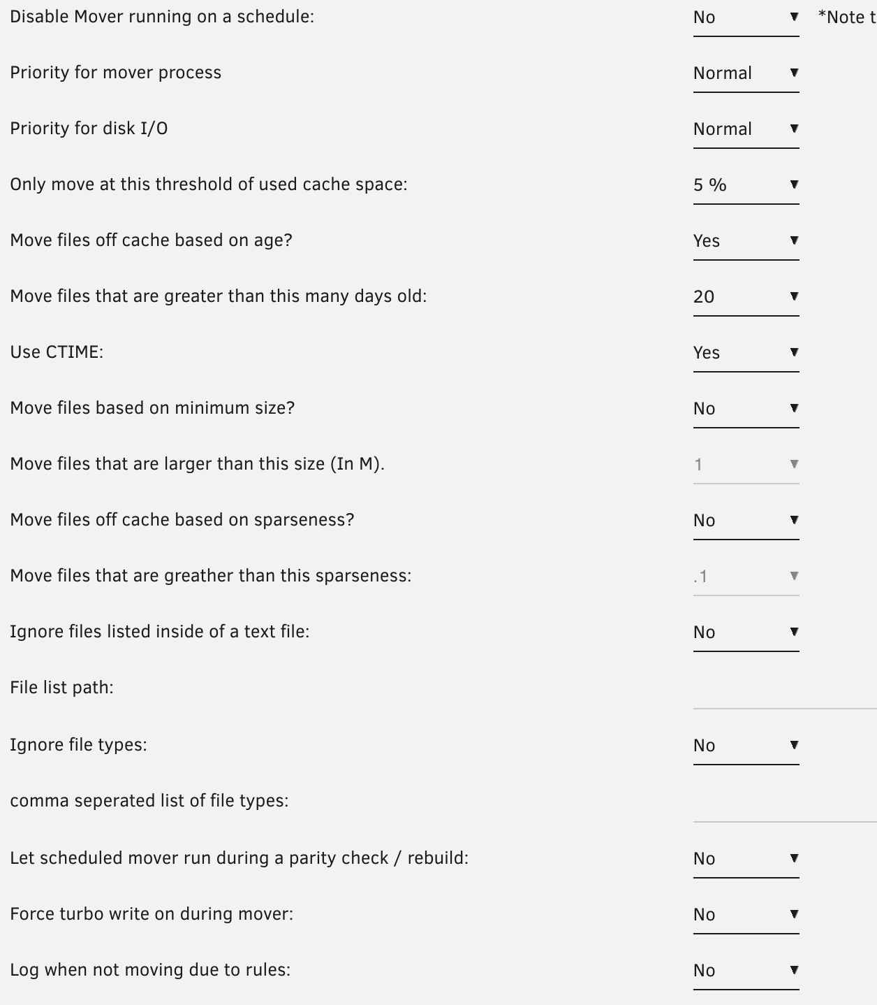

I have my system setup to check every day in the AM, look for at least 10% used and move files that are 20 days old.
So in a sense it does move the oldest files first the 20day files and then keeps moving the oldest every day

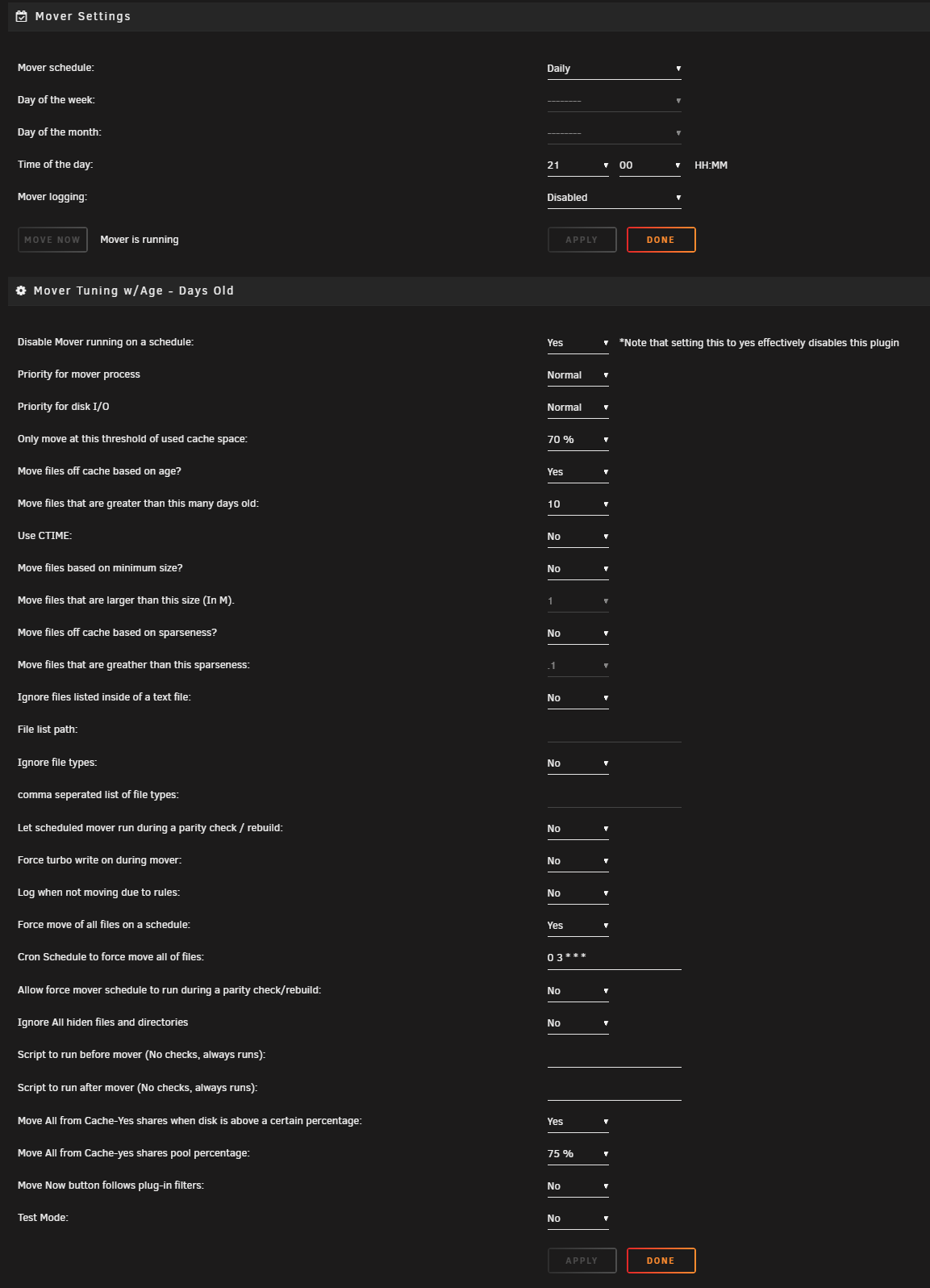

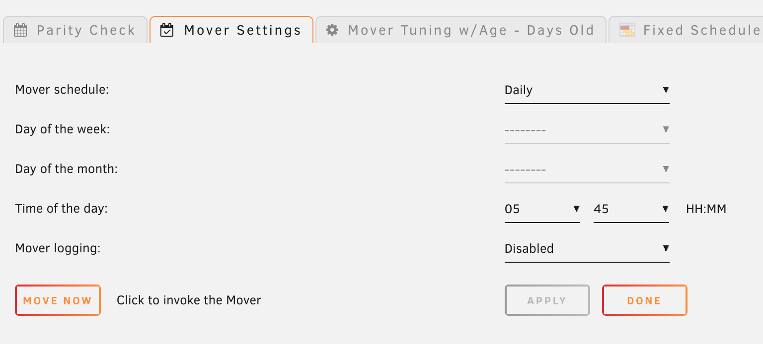

@HDT
Like I said I have my system setup to move files daily at 5:45 and it only moves files 20 days old

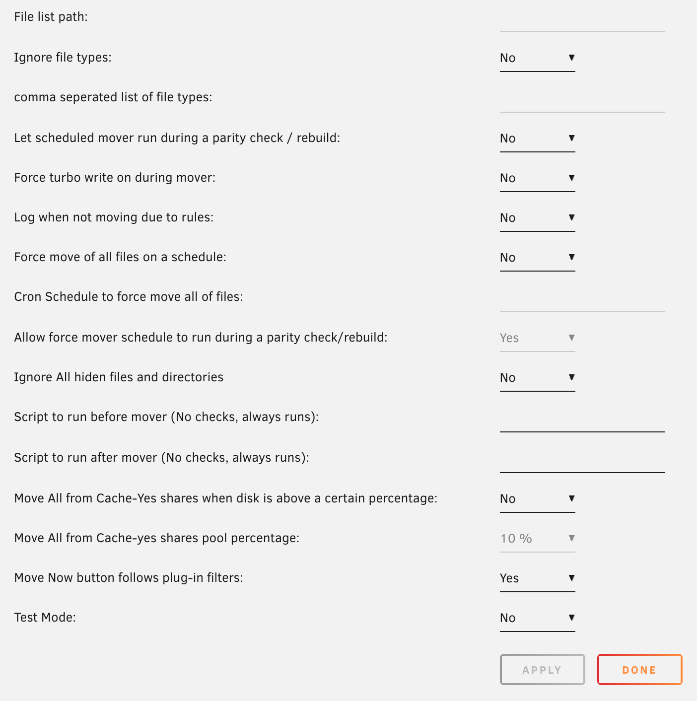

For some reason, I can't get the mover to run at 70 % threshold, and if the files are more than 10 days old.
I'm sure I made a mistake somewhere, I just can't find it.
Here's a picture of my settings:
Can someone tell me where I got it wrong?

it is generally looking all fine, we talk about a manual test scenario ? as you disabled automation more or less ...
I've tried both Yes and No in the one you highlited, it doens't move it when it's 70 % full :/

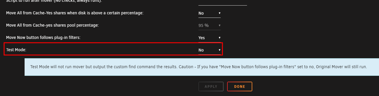

may try this then to debug ...

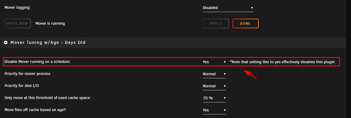

You want to make sure the top one Disabled is set to NO.
Setting it to YES tells the script not to run.
Setting it to NO tells the script not to run.
Which one? The original mover, or the mover tuner?

I posted my exact settings up above a bit. I also fixed what I posted a couple days ago that you qouted me on. You do not want the top line to be YES, Yes means disable the plugin. The last line setting it to yes means enable TEST mode. You want things to move, you have to use NO on the last line too.
On a side note you can enable Logging and click the button to move and watch files move while watching the logs using Test mode. Or you can disable TEST mode and watch the logs as well. I normally enable TEST and Logging so I can see what the script would do and when I'm happy turn off TEST and let it go.
I used to keep logging and check things, but I've since disabled Logging and have my files move once a day vs every hour because I have my server setup to move files, do Plex maintenance and other things between the hours of 6AM and 8AM every morning. Otherwise my drives sleep all day.

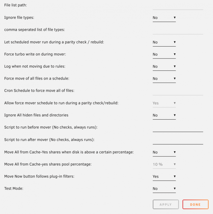

I tried setting it up with the picture you referred to, but now the mover is not moving at all, not even manually.
I can't figure out why I'm having problems with it. Everything else is running perfectly, Unraid is super stable for me and it's all good dancing on rainbows and all that, but the mover/cache just refuses to work...
