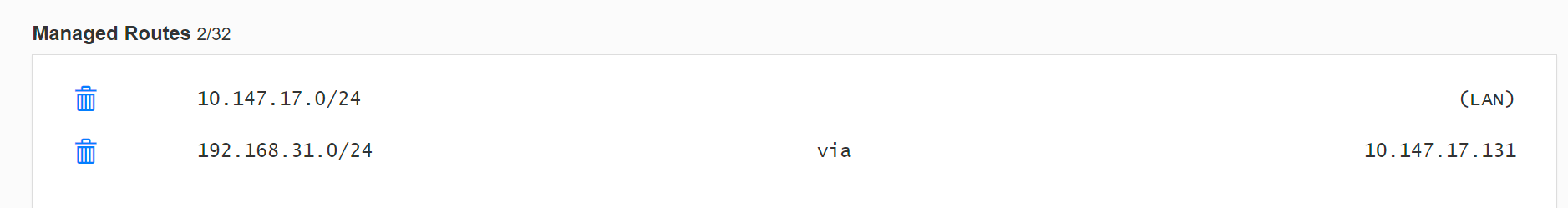

Also: ZT is not doing NAT, so ZT clients will connect to any service with IPs from the 192.-168.191.0/24 range.
So you want pfsense to allow traffic originating from 192.168.191.0/24 and destination 10.1.30.1 (plex)
I tried my best, is this rule ok?
Alias zt_net_plex = 192.168.191.0/24
Alias media = 10.1.30.1
I'm unable to ping plex over zerotier..:/
...then, in ZT central add a single route to the plex host 10.1.30.1/32 with gateway 192.168.191.2 (which is your zt-docker).

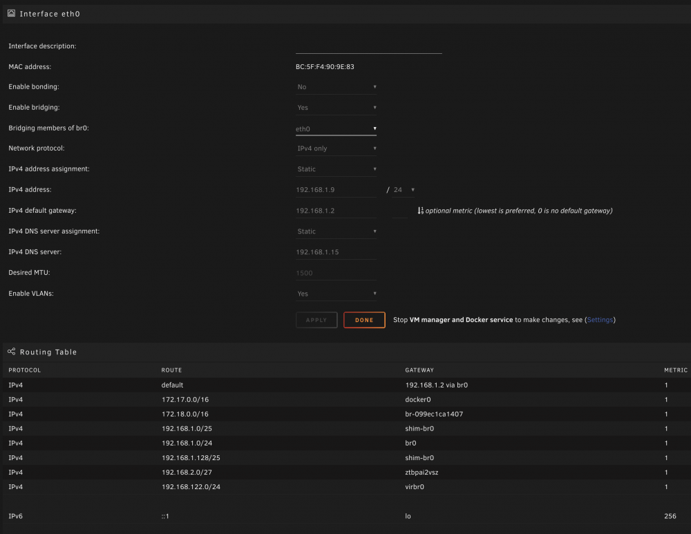

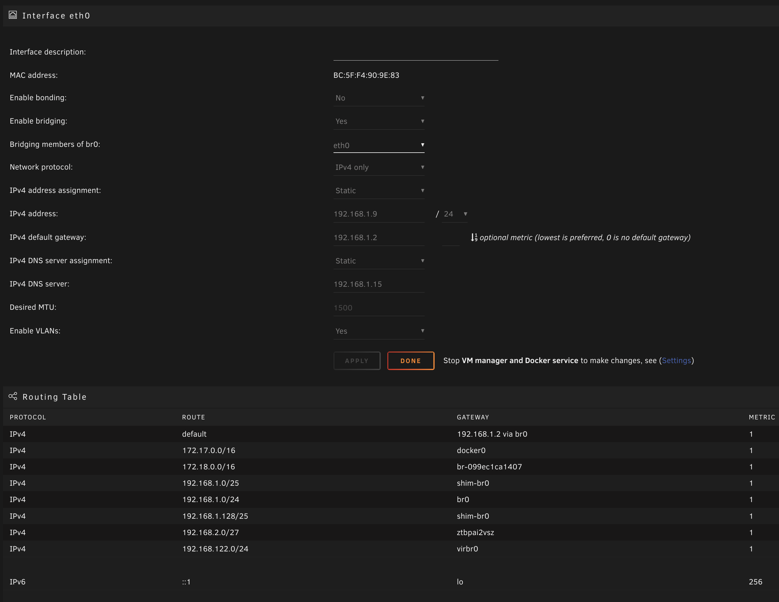

please Check the routes on unraid host (what is the output of "route -n" via command line)?
We need to find out which path packets from zt-clients go when trying to reach plex and also which way return packets from plex go, trying to get back to a zt-client. Here the correct gateway is 10.1.100.201 (the "iunraid"-side/IP of your zt-docker).
All will depend on the routing table if unraid can identify the route/path locally or will use the default gateway (your pfsense).
FYI I'm using 3 eth-ports, whereas only port-1 is used/bridged for docker;
- I have absolutely no clue where 172.17.0.0 and 192.168.122.0 come from (sweating a little bit..)

1 hour ago, Hank Moody said:
here you can see, that on the unraid host, there is no known route to zt-network (192.168.191.0/255.255.255.0).
Hence you need to route traffic via your pfsense...create the static route as described above....plex and zt-clients will, based on that routing table on your unraid host, direct outgoing traffic to your pfsense (the default gateways 10.1.30.254 / 10.1.100.254).
these are default interfaces/IP-nets for Docker and Virtual-Machines, for when no custom network is used ... don't worry.
....looks like you "only" need to get your pfsense setup updated. Unfortunately, I am not familiar with these, sorry.

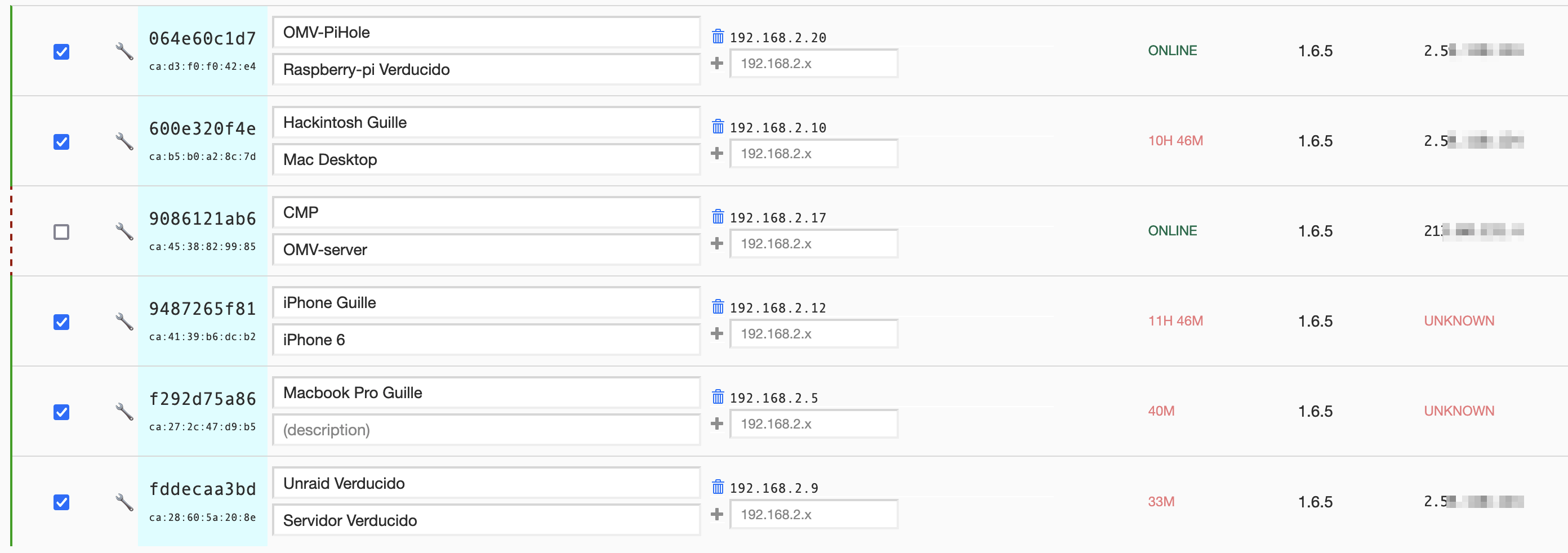

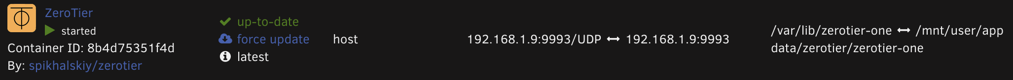

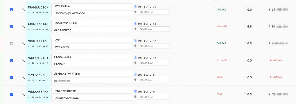

Hi! Thanks to bring this app to Unraid, It's a great solution for people like me that don't want to deal with more complex VPNs.
I spent some days reading this topic but I'm having trouble to set up your container. If I used it as a Host network it goes always as Offline mode, if I use it as Bridge it connects and I can ping it from other devices with the ZT ip for the container, but I don't have access to Unraid webgui, I only can access to containers that I use with the parameter "-net=container:ZeroTier" but seems not to comunicate with Unraid it self.
I can access, without problem, other servers at home that I install ZeroTier as a service, like one server that has OMV 5 installed (Raspberry Pi Debian). And my computers (Macos) can access each other wihtout problem with the ZT lan. I can share files, remote control display...)
Maybe is something related to that my LAN is behind a double-nat router system. As I got connected by an Ubiquiti "LiteBeam 5AC Gen2" antenna that I don't control, which is plugged to my pfSense router on the WAN port.
For example to use Plex remotely I had to ask my ISP to open the Plex port and port-forward it to my Unraid server on the pfSense router.
But if this is the case, I don't get why my Raspberry Pi with ZeroTier as services conects fine.
I also tried to use the 1.6.2 tag but without luck, so I guess is something related to my setup.
Hope someone can get me on the right direction. Thanks in advance!

EDIT:
After one hour running the docker container on Host mode, seems to be connected right now. Maybe in my case it took longer to connect on Host mode, strange. I have access to Unraid Webgui and can ssh using 4g phone connection.
Hope it still running without problems.
I'm going to leave this post as maybe someone with same problem can just try to leave it running for a while.
EDIT 2:
Now seems not be connecting again. For no reason.
