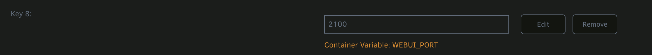

7 hours ago, Matt0925 said:
Yes I have-
I also changed the ports-
And finally added the webUI port and deleted the original config on it-
I tried deleting it and starting fresh, still directed to the original 8080. Interestingly despite my settings in the config file it still showed the port as 8080. When changed there to 8081 and saved it still brings up port 8080, so that wasn't it.
I feel like there must be something small I'm missing but I have no idea what it is?
the above all looks good to me, however i dont see a screenshot confirming you have change WEBUI_PORT env var, this is important and must also be changed, in your case to 8081, screenshot showing mine (2100 for me):-

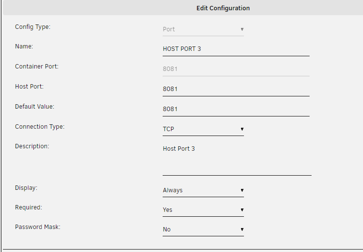

I had done this by using the add another path, port, variable, label or device option-
Should I have named it WEBUI_PORT like you did? Though after seeing your example I tried changing key 8 like you have done and still no change.
i think there is some confusion here, so you need to set 'variable' (not 'port') with key name WEBUI_PORT and the 'value' has to be the port number you want, this variable should already exist, you want to set the value to 8081. next up you need to 'remove' the 'port' for 8080 for this container, then add a 'port' and set it to 8081 for 'container port' and 'host port', dont worry about setting anything else. last step is to edit the 'WebUI' entry (requires 'advanced view' toggled on) and set the port to 8081 (see my previous screenshot above).
if you are still stuck then switch on 'advanced view' and post a screenshot showing all settings, mask out username and password though.
