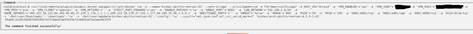

I seem to have the container running OK again, however with the number of files seeding I'd ideally like to set up a second instance of the container. As far as I'm aware you need to make three changes- name, app data folder and port numbers.
Looking at the log it looks to start up find, but opening the webUI the page cannot be found and won't connect. Any thoughts on what I could be doing wrong?
Also sorry if this was posted somewhere previously in the thread, I searched but couldn't find anything on it.

You should attach your docker run command and supervisord log to your next post. Be sure to redact user/password in both.
Both are now attached.

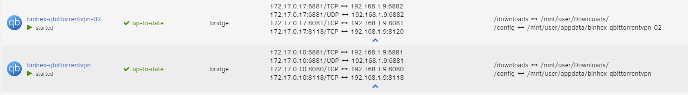

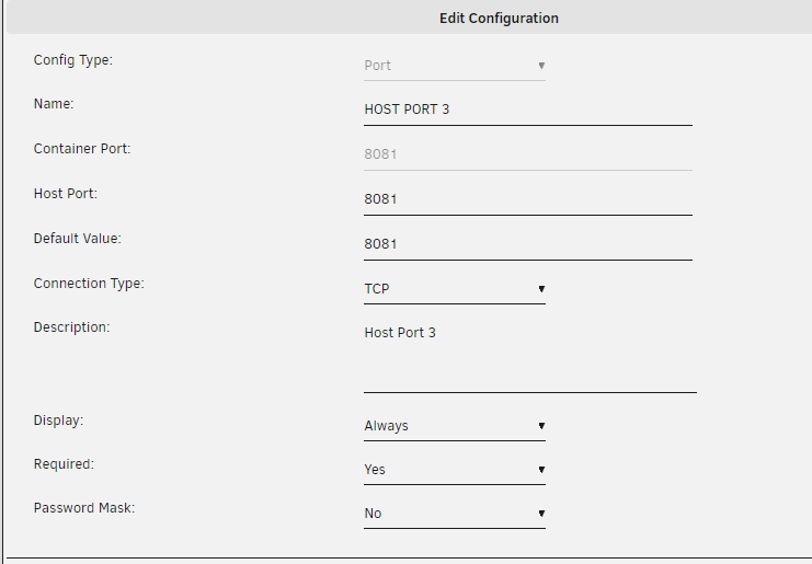

Well interesting development. Adding a new port for it and deleting the original one does load up qBit on the webUI, however it directs to the original instance of it on port 8080 rather than the new one despite pointing to 8081 and app data in a different spot
And you changed both sides of 8080 (8081:8081) plus set the webUI port to 8081?
Yes I did
have you also changed the template to reflect the port change?, im assuming we are talking about the functionality of left click icon, select webui right?, if so then left click icon, select edit and then toggle 'advanced view' and edit the port for 'WebUI', for instance mine looks like this:-
http://[IP]:[PORT:2100]/
which means when i click on the webui link for the app it takes me to unraid host ip and port 2100, you will need to alter this to be what the new port is now defined as for your second instance.
Yes I have-
I also changed the ports-
And finally added the webUI port and deleted the original config on it-
I tried deleting it and starting fresh, still directed to the original 8080. Interestingly despite my settings in the config file it still showed the port as 8080. When changed there to 8081 and saved it still brings up port 8080, so that wasn't it.
I feel like there must be something small I'm missing but I have no idea what it is?
