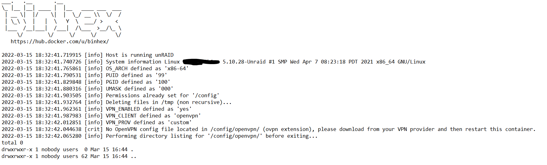

I was not setting anything up yet in terms of Downloads and VPN creds. Just want to make sure the docker works properly first and then will edit. Here is the log below hopefully that is the correct one i opened up appdata/binhex-qbittorrentvpn/supervisord.log. Also, now for some reason I can't start the qbVPN anymore. Thanks.
[crit] No Openvpn config file located in /config/openvpn/ (ovpn extension), please download from your VPN provider and then restart this contalner.
You need to install the .ovpn file you downloaded from PIA.
Done that now and container starts. From the log I can see that the opnvpn file is working(log attached). Still can not hit the WEBUI.

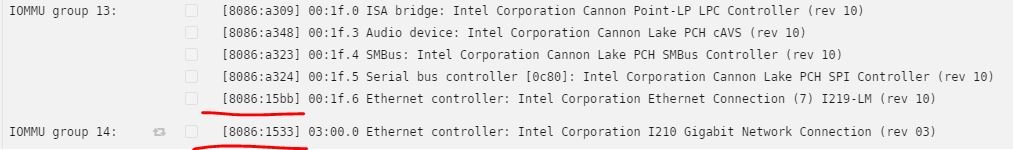

  • I have two physical NICs. eth0 is bridged and allocated to server control and VM network. eth1 is bridged and allocated to Docker network(see attached). Controllers are in the separate IOMMU groups.
  • I am using eth1(br1) to connect to the QBVPN container on the 192.168.0.0/24 network.
  • I can hit other containers on the eth1(br1) 192.168.0.0/24 network(see attached).
  • I can hit VM on the eth0(br0) 192.168.10.0/24 network(see attached).

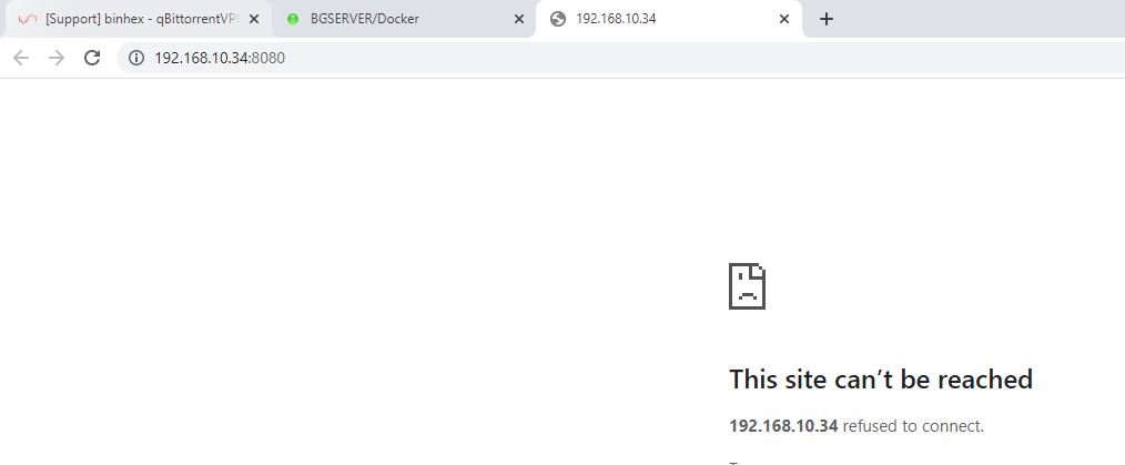

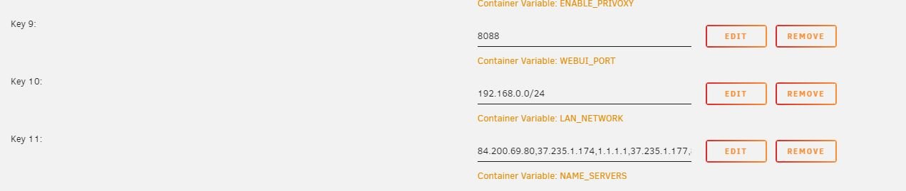

The other thing is - the port is not changing from 8080 to 8088

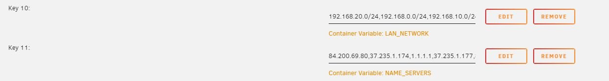

then that is your issue, iptables built into qbittorrent will block this, it doesnt matter whether your lan allows it, iptables in the container will not!.
add 192.168.20.0/24 to LAN_NETWORK, use a comma to separate if you want to access the web ui from several networks.
tried that, no luck...

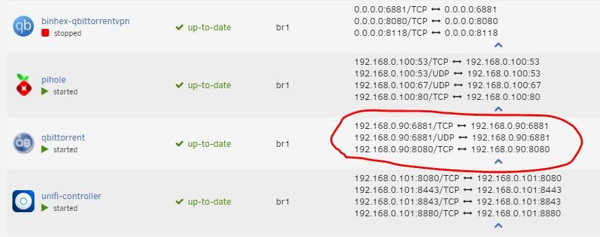

i see from your screenshots you are using macvlan as well (specific ip for the container), this will not work, you need to set this to 'bridge', not 'br1'.
tried that too...

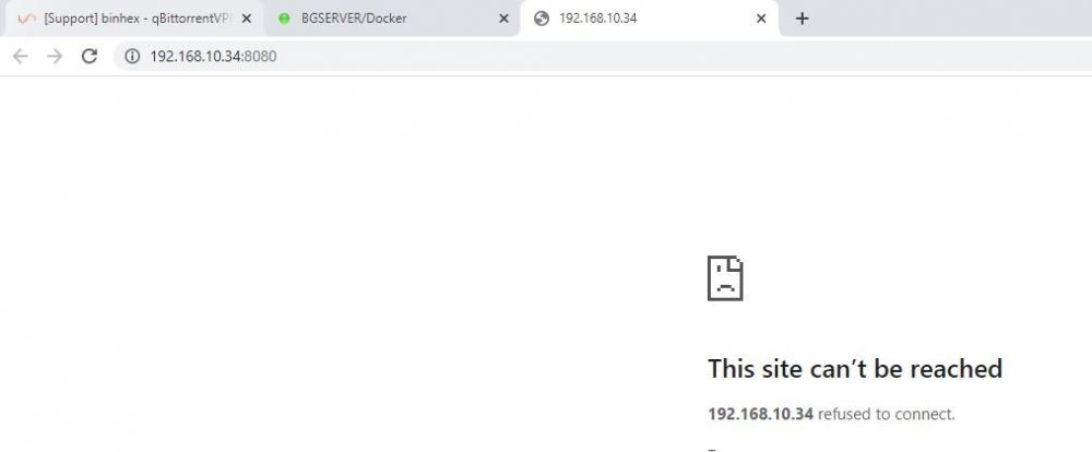

here is the snap shot.
11 minutes ago, BKG said:
tried that too...

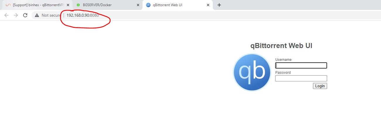

That screenshot shows that you are trying to connect to port 8080. Isn’t the webUI set to 8088?
@wgstarks I know, that is the problem. No matter what changes I make to the port it sticks with 8080.
What do you mean it's now defined as 8088 as can be seen in your screenshot, try hiring that URL with let 8088
