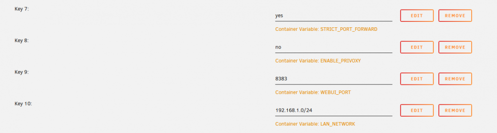

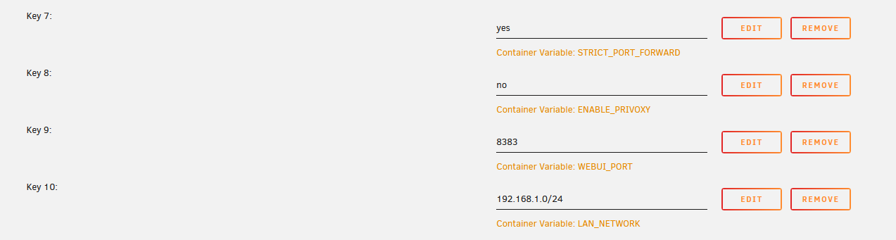

I have been trying to get the binhex-qbittorrent docker running for the last few days but have failed.
The logs show no errors, if I run curl ifconfig.io it's showing an IP from my VPN provider. The last message in the log is that qbittorrent process is listening on port 8383 (8080 is reserved for sabnzbd). I have changed this in the advanced settings, verified that it's set in the config file, navigated to it manually, it's showing correctly in Unraid for the port mappings, etc.
No matter what I try, the WebUI will not pull up. I've tried in different browsers, incognito mode, etc. Any ideas?
Are you trying to connect from the same subnet?
@wgstarks I am, my PC is 192.168.1.10, the server is 192.168.1.170 and I have the LAN_NETWORK the default as 192.168.1.0/24
And you set webUI to 8383, did you also create a new port 8383:8383?

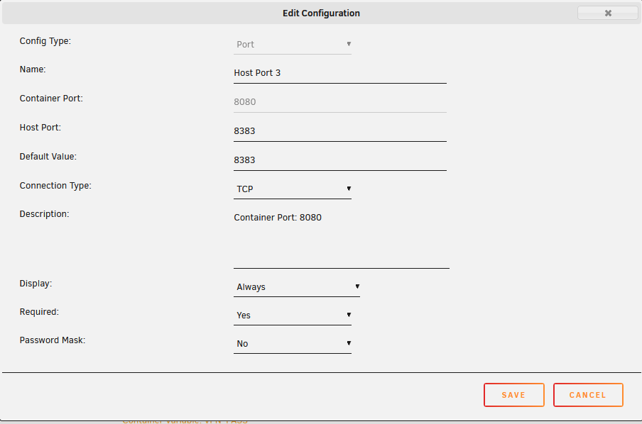

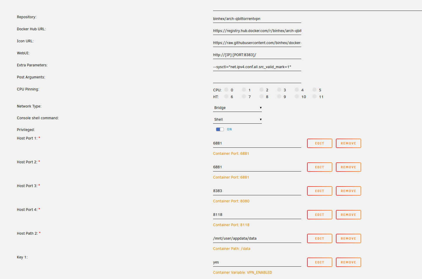

This is what I have it set to currently, maybe I am missing something? The only ports I changed are where 8080 was referenced. I didn't touch anything else, that's all default. Also on Key 9: I have 8383 set for WEBUI_PORT
On host port 3 click edit and be sure host port and container port are both set to 8383.
So that might be the issue...the container port shows 8080, but I can't edit this. Do you happen to know how I can modify that value? image.png.7c98f7b5ab75c5772b7d951a0e67a133.png
Try deleting the entire item and creating a new port config.
You’re right. I had forgotten that you can’t edit it directly.
