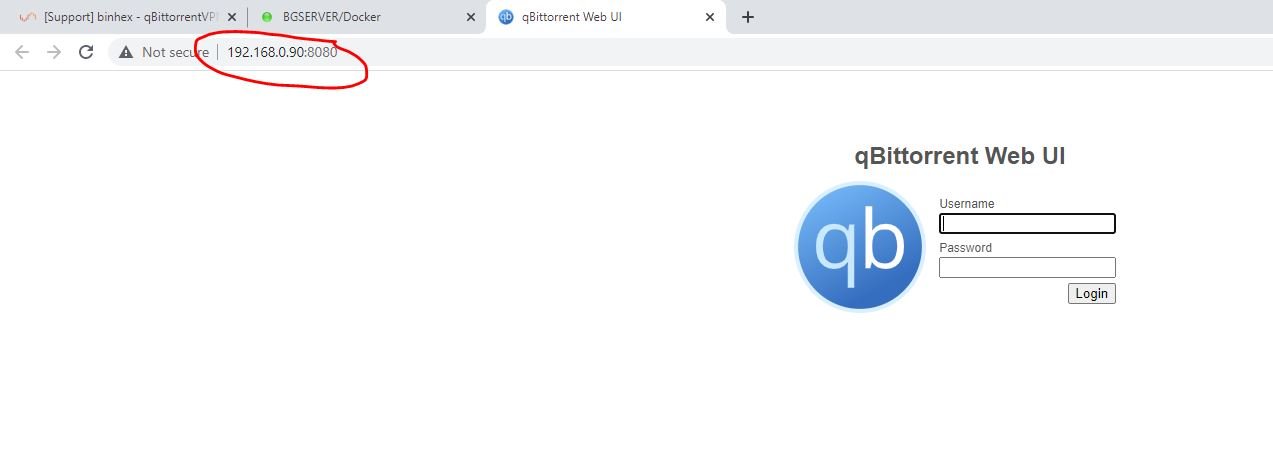

@wgstarks I know, that is the problem. No matter what changes I make to the port it sticks with 8080.
What do you get when you browse to port 8088?

!!!it works now with 8088!!! but i did try that earlier by changing the manually in the web browser from 8080-to-8088 and it didn't work.
I think I know what was the problem:
  • when I tried originally it did not work even when I manually changed the port 8080-to8088 in the browser after trying the WEBUI. I believe the reason for that was that i was trying the container without the VPN config file being placed into the ovpn folder.
  • Now, it works with the default port 8080 which I just changed in the config.
  • Now, it works with only one network in the LAN_NETWORK 192.168.0.0/24
Verdict - it needs to have a valid ovpn config in order to run. It seems there is no need to change the default port.

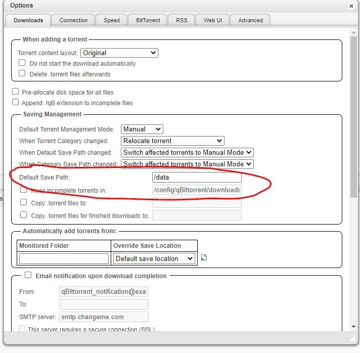

Hi wgstarks, i have one more question to ask for the downloaded data. I have modified the path for /mnt/user/appdata/ to a new path on the dedicated share, but the download content still lands in the /mnt/cache/appdata/binhex-qbittorrentvpn/qBittorrent/downloads.
Do I have to do anything with the download management in the qbittorrent?

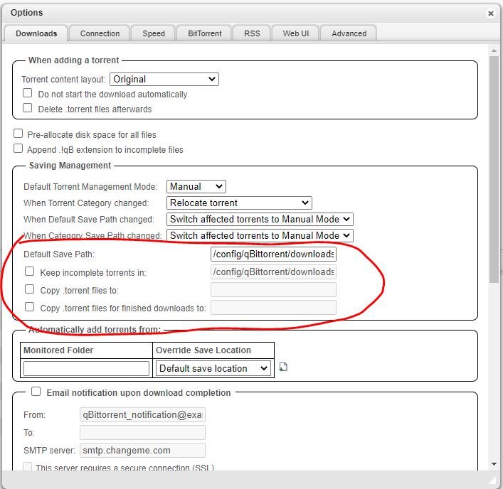

Right there in your screenshot, container path is /data, but you are saving content to /config...
I see. I thought /config/qBittorrent/downloads is the place wher the QB is saving the torrent files and not the actual downloaded content. Forgive my ignorance, my downloading days were long in the past 10 years ago and i now almost start from scratch. Also, i am new to dockers and thought if I specified the path in the container template it would overwrite the rest.
So to be clear the current /config/qBittorrent/downloads path must be changed to /mnt/user/MULTIMEDIA/downloads?
No, /mnt/user/MULTIMEDIA doesn't exist in the container, only the host. /data is the container side mapping.
bare with me please... so the end result should be like in the screen shot?qb_3.JPG.f82b1c4b965f38352555363fb71adcc1.JPG
Just tested with the downloads and it does exactly what I wanted. Thanks @JonathamM
Great! Hopefully you understand better what is going on with path mapping now. It's essential to understand when you are troubleshooting containers.
Thank you all again.
