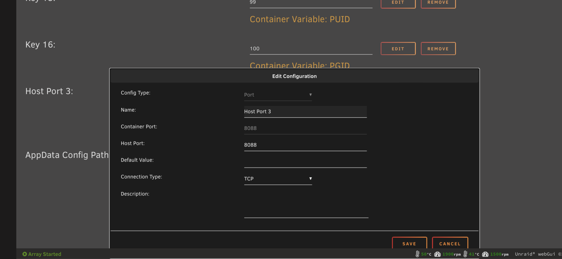

Host port 3 is set to 8811 for the host port but your screenshot doesn’t show the container port. It must also be set to 8811. If you can’t edit the existing port (you probably can’t) just delete it and create a new port mapping 8811:8811.
Thanks a thousand times @wgstarks, I removed Host Port 3 and re-created it on 8811, and yes it woks now!
I'm such a noob using docker, so mega much thanks! So obvious and although so unclear!!!!!! Thanksssss! 🤪

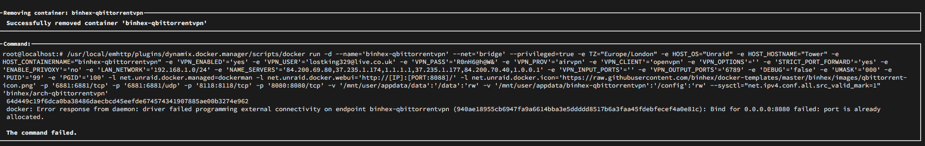

Hi - I'm having a probem switching from Bridge to Host mode...
I've had a look around but I've not found any simular posts (may be I'm not looking right).
Could any one make anu suggestions based on this error ?
Execution error / Server error
root@localhost:# /usr/local/emhttp/plugins/dynamix.docker.manager/scripts/docker run -d --name='binhex-qbittorrentvpn' --net='host' --privileged=true -e TZ="Europe/London" -e HOST_OS="Unraid" -e HOST_HOSTNAME="tbmaindoma" -e HOST_CONTAINERNAME="binhex-qbittorrentvpn" -e 'TCP_PORT_6881'='6881' -e 'UDP_PORT_6881'='6881' -e 'TCP_PORT_8080'='8080' -e 'TCP_PORT_8118'='8118' -e 'VPN_ENABLED'='no' -e 'VPN_USER'='vpn username' -e 'VPN_PASS'='vpn password' -e 'VPN_PROV'='pia' -e 'VPN_CLIENT'='openvpn' -e 'VPN_OPTIONS'='' -e 'STRICT_PORT_FORWARD'='yes' -e 'ENABLE_PRIVOXY'='no' -e 'WEBUI_PORT'='8080' -e 'LAN_NETWORK'='192.168.1.0/24' -e 'NAME_SERVERS'='84.200.69.80,37.235.1.174,1.1.1.1,37.235.1.177,84.200.70.40,1.0.0.1' -e 'VPN_INPUT_PORTS'='' -e 'VPN_OUTPUT_PORTS'='' -e 'DEBUG'='false' -e 'UMASK'='000' -e 'PUID'='99' -e 'PGID'='100' -l net.unraid.docker.managed=dockerman -l net.unraid.docker.webui='http://[IP]:[PORT:8080]/' -l net.unraid.docker.icon='https://raw.githubusercontent.com/binhex/docker-templates/master/binhex/images/qbittorrent-icon.png' -v '/mnt/disks/WD-WCAU41281929/downloads/':'/data':'rw' -v '/mnt/user/appdata/binhex-qbittorrentvpn':'/config':'rw' --sysctl="net.ipv4.conf.all.src_valid_mark=1" 'binhex/arch-qbittorrentvpn'
1d1dc8ce5f836506820bcd067190d146abfc6e9cc48f3b5a0e609221491180ec
docker: Error response from daemon: failed to create shim: OCI runtime create failed: sysctl "net.ipv4.conf.all.src_valid_mark" not allowed in host network namespace: unknown.
The command failed.

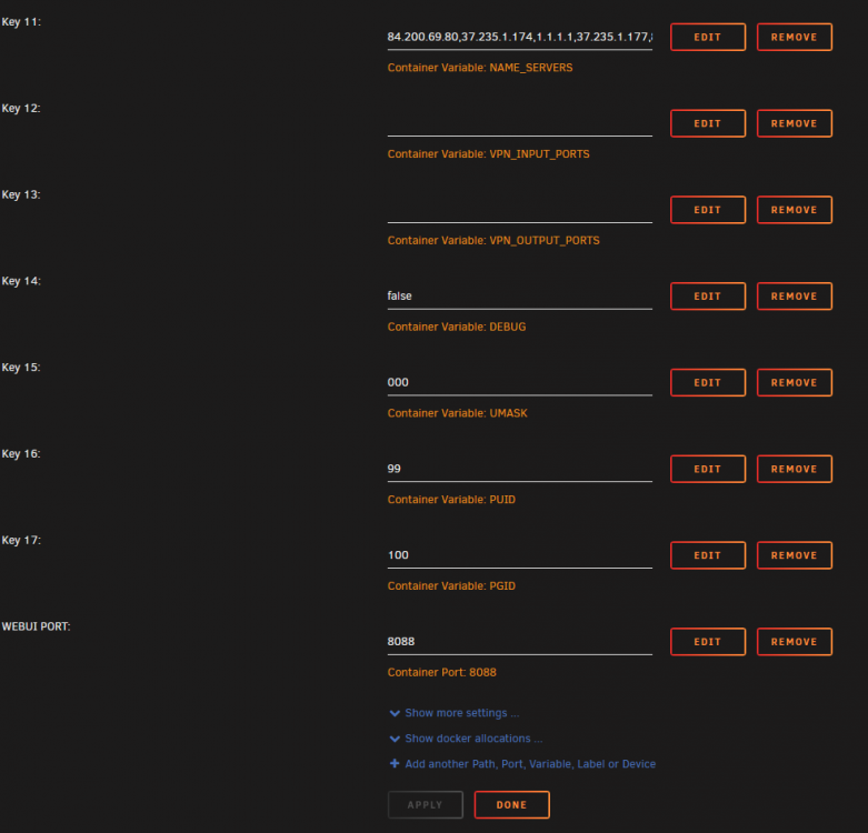

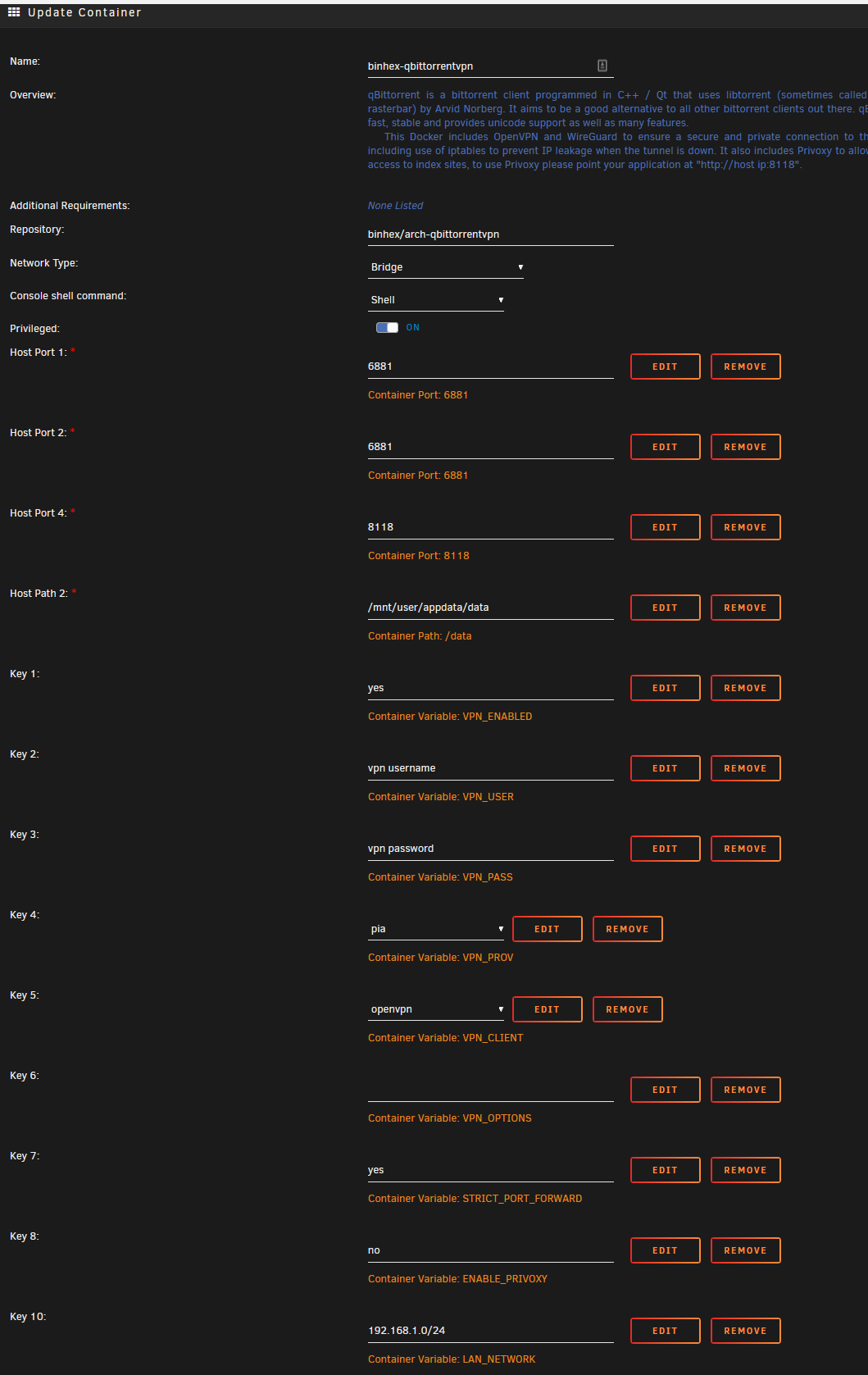

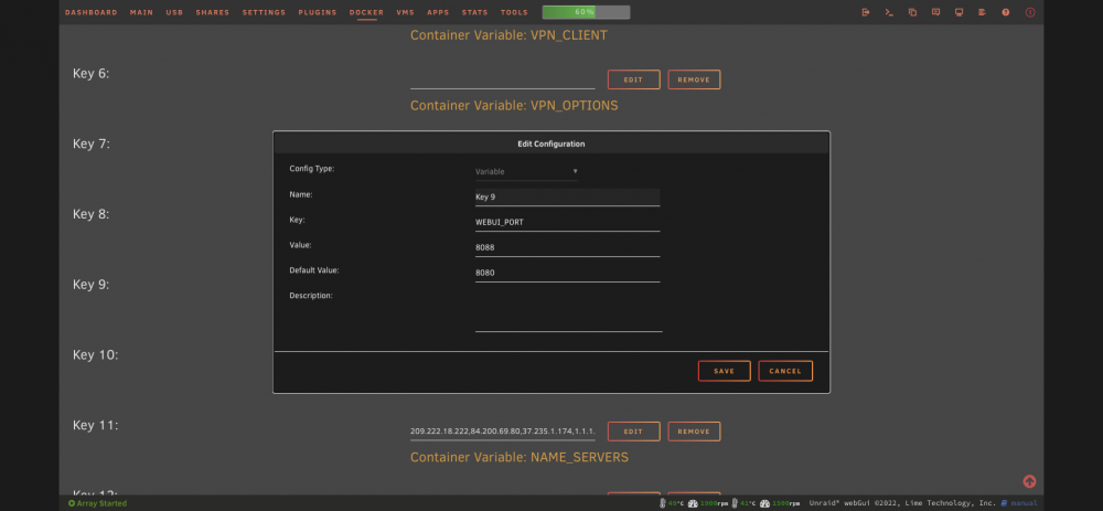

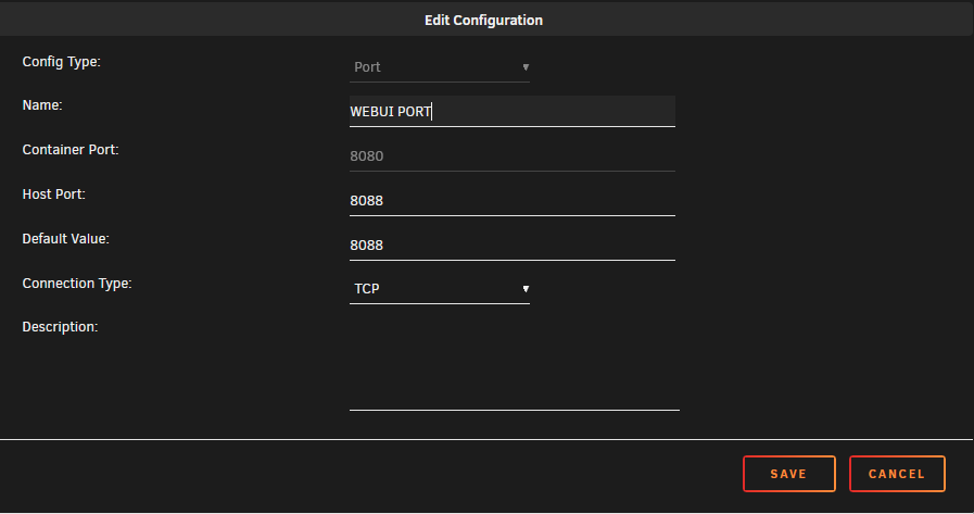

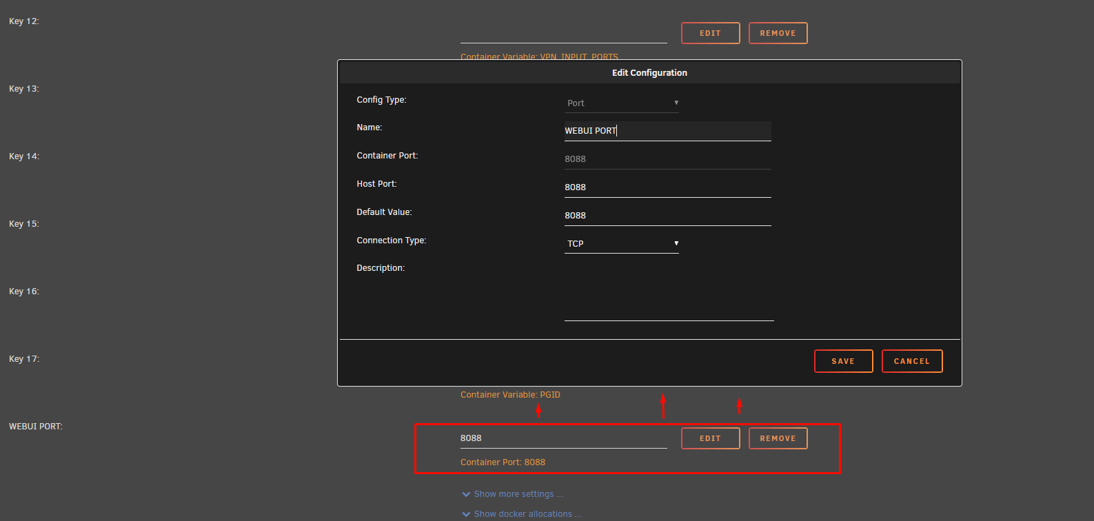

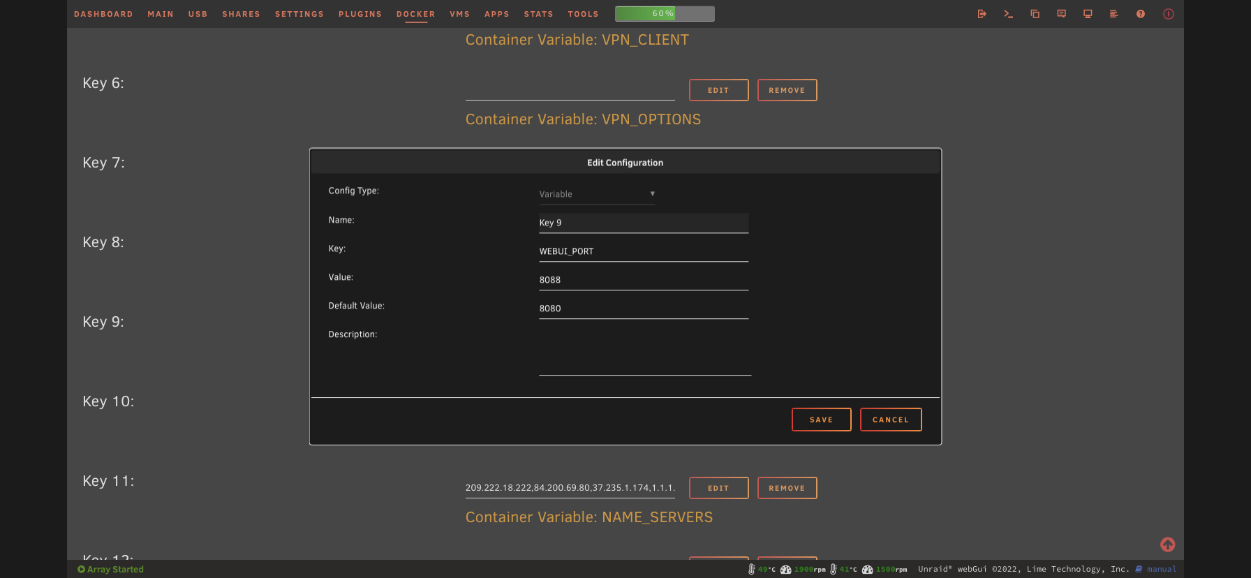

I am having a little trouble getting into the WEB UI.
I have removed Host Port 3 and added it back in to set the Container and the host ports both to 8088 however I don't seem to be able to access the UI. any suggestions?
Here is a screenshot of my settings:
1 minute ago, SnugglyDino said:
Is it worth picking a PIA server that uses port forwarding even if it's not my closest server?
forwarding is pretty much a necessity for successful torrenting
Does the supervisord log show a successful connection to the VPN?
Did you put your actual credentials in for the VPN instead of the placeholders shown in your screenshots?
Looking at the logs, I am getting this if it's any help ?
LOGS:
Spoiler
text  error  warn  system  array  login

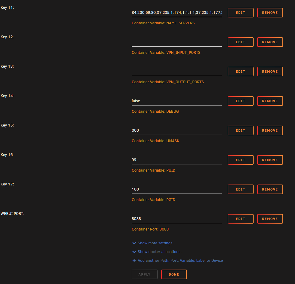

Your screenshot doesn’t show all the settings. Is webUI set to 8088.
Also might be a good idea to attach your supervisord log to your next post.
supervisord.logHey @wgstarks
The WEBUI is set to port: 8088, I deleted the default one and added it back so that it would set the host and container ports to 8088.
I have attached my supervisord for you to take a look :)

Hi @JonathanM,
I though I had done the correct method by deleting the default "WEBUI" port and making it again to set the host and container ports both to 8088?
Here you can see what I did:
If there is something i'm missing could you please point me in the right direction for how I may go and change it as I thought all ports were handled though the settings of the container as shown above?
Just now, ArxKnight said:
Hi @JonathanM,
Not that I pay much attention to binhex's threads as he's great at supporting them, but I do have a question
Why are you changing the container port?  The container is running as bridge which means that you generally leave the container port alone (8080) and simply edit it to change the host port (to 8088)  There's no conflict by having multiple containers all listening internally on 8080 as that's what the port mapping is supposed to do.
The way that you're doing this means getting into the container's UI (which is still internally on 8080, but no port mapping now available for it), telling it to listen instead on 8088, deleting and adding the port (which you've done) in the template, and also changing the WebUI entry in the template to reflect now 8088 instead of how it was originally set (which works no matter how you map the port)
This BTW is why on the template you cannot edit the container port number and have to instead delete and re-add

I am changing the container port as I already have another container running in brigde mode with the same port so I would have thought that trying to run this also on the same IP/Port would cause a conflict.
hmmm, it seems after those steps it still claims this:
Spoiler
2022-07-27 15:53:17,323 DEBG 'watchdog-script' stdout output:
[info] qBittorrent process started
[info] Waiting for qBittorrent process to start listening on port 8080...
2022-07-27 15:53:17,432 DEBG 'watchdog-script' stdout output:
[info] qBittorrent process listening on port 8080
Tried changing it 8080 just to see if I would be correct and indeed I cannot use the consiner on port: 8088 as it's currently in use via another container.
UPDATE:
It seems that I can run the conainer port on 8080 and then just run the host port on 8088 which does give something but it looks like it's showing "Unauthorized"? I don't know what this could mean though.
Edited by ArxKnight
You have deleted the existing webUI port variable and created a port to replace it. That’s not going to work. You should have edited the existing webUI port variable and changed it to 8088 (see screenshot).
You would also need to delete the port mapping for 8080 and create a new one for 8088.
Im not sure exactly what you have now but you may want to delete whatever you have for these two items and create new ones to match the screenshots.
from your screenshot it looks like you defined the 'Name' of the port incorrectly, its not 'WEBUI PORT' its 'WEBUI_PORT' and the type is wrong, its a variable NOT a port.
@Squid you are quite right, the user should not be redefining the container port - however qbittorrent is an exception to the case here, here are my notes from the qbittorrent README.md (geared more towards non unraid users, but you get the gist):-
Due to issues with CSRF and port mapping, should you require to alter the port for the webui you need to change both sides of the -p 8080 switch AND set the WEBUI_PORT variable to the new port.
For example, to set the port to 8090 you need to set -p 8090:8090 and -e WEBUI_PORT=8090
so for unraid users that means setting WEBUI_PORT to the port you want and then re-creating the port to match (host and container side being the same).
i then have some code to pick up the env var WEBUI_PORT to set the port for the running application (qbittorrent in this case).
He didn’t create an env var. He created a port for WEBUI_PORT.
indeed!, i spotted that in the screenshot:-
