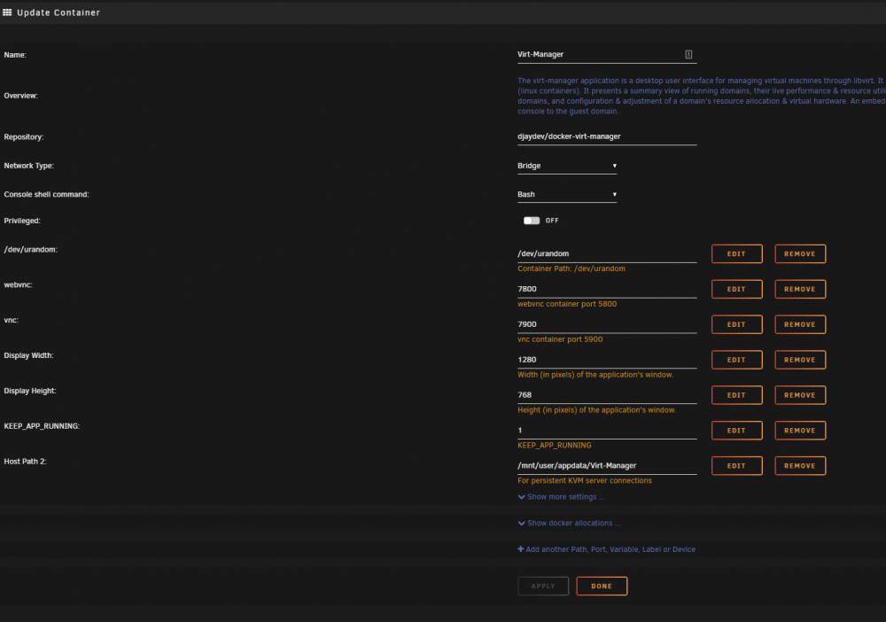

Morning folks.  I'm trying to use the virt-manager docker to clone a VM I've created.  It's a WIN10 sandbox VM for testing software builds, etc.  I have the vm created on the unraid host, it works properly, etc.  When I load up virt-manager, click clone and tell it to go, I get  the following error:
It's a simple VM - 30G disk image and the connection to the virtio ISO, 2 cores, 4gb mem, nothing special about the vm really.

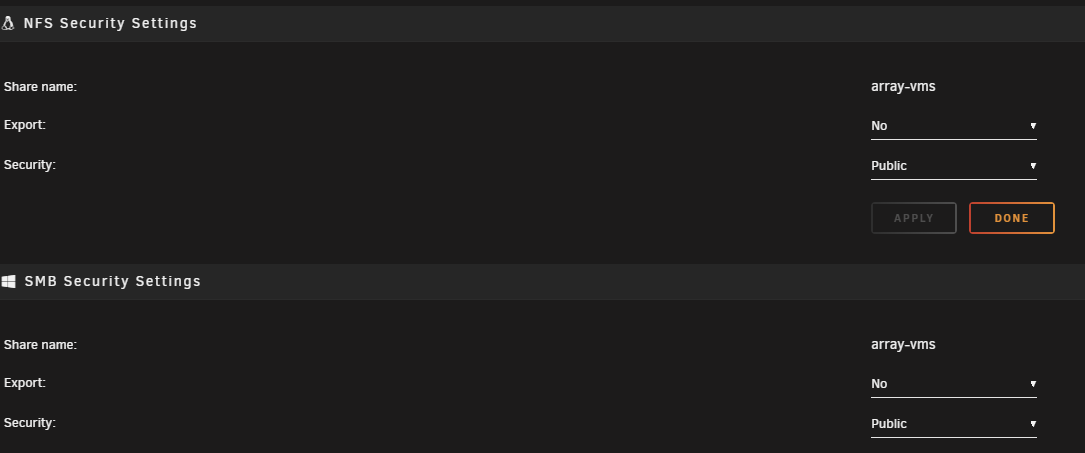

1) yes - the disk location for this particular VM is on the array and not cache (intentionally) - array VMs is a share that is hidden, but is public:
2) I tried the docker with privileged mode both on and off and I get the same error.
3) I'm logged into virt-manager as root
Any ideas?  I've tried searching google but not having much luck.
Thanks!
Thanks!
Hi @JasonK
Can you share the details of the volumes you have attached to the virt-manager docker container?
12 minutes ago, dee31797 said:
Hi @JasonK

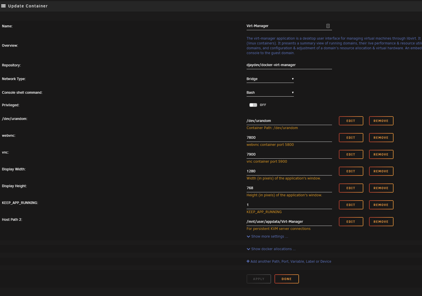

Here's a screencap of the docker config.  The docker can see all the VMs I have on the server, start/stop/etc without issue:
Thanks,
My initial guess was that the volume had to be mounted to the container, but I tested that just now and I still got the same error you got.
Guess #2, the container is missing software that it needs for cloning.  I built it to be small as possible and never considered using cloning within the container. So there's a good chance that one of the long list of optional packages Virt-Manager lists is needed for cloning :(
If I figure it out I'll have to update the container image and when I do I'll let you know.
