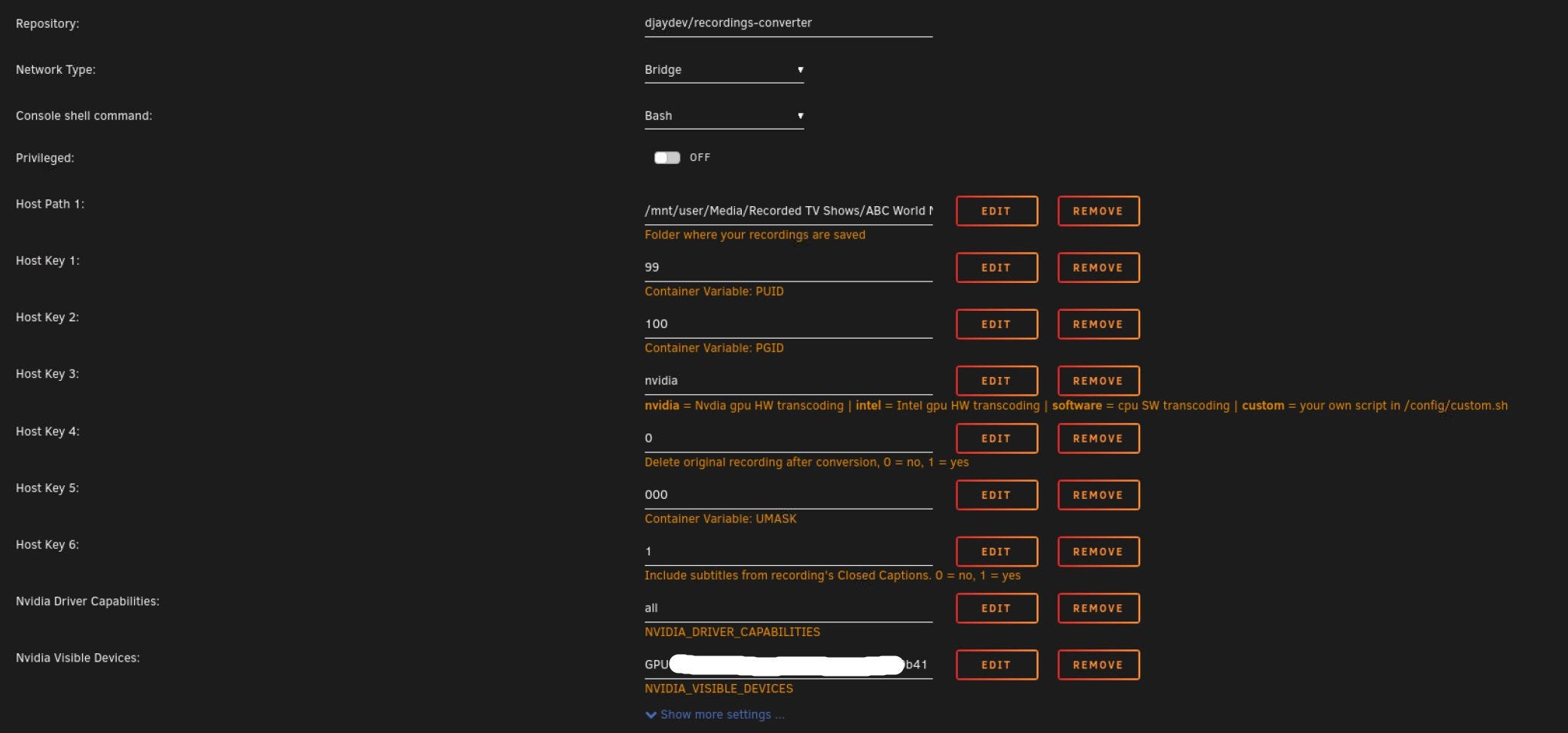

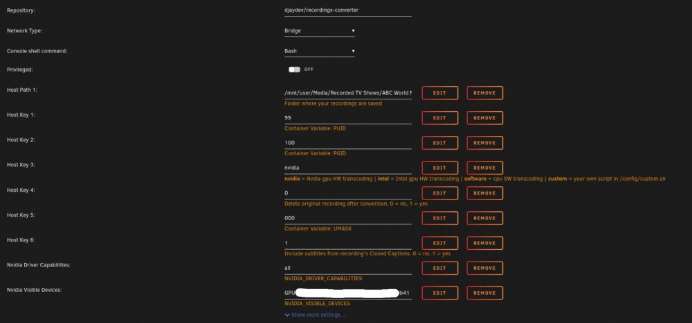

I installed recordings-converter and tested it out on a couple of files. Conversion logs are attached.
A few questions:
1) I think I've set it up correctly to use my GPU. Is the attached configuration correct?
2) While the docker was doing its work, I did see load on the GPU and an ffmpeg process. But there was still 5-10% load on the CPU (and no other docker should have been using that much CPU resources at the time). Is this expected behavior?
3) Does the container work on multiple files sequentially or concurrently? So far I've tested the container only on folders with one recording in them. When I switch to my entire recordings folder, I just want to make sure my other containers/VMs etc aren't affected.
4) I am using my GPU for hardware transcoding in Plex and Emby as well. It is my understanding that as long as my GPU isn't passed through to a VM, multiple Dockers can use the GPU concurrently. Is my understanding correct?
Thanks for your help and a bigger thanks for all your work on these containers. Definitely makes my life easier!
postProcess.18-03-2020-0712.log postProcess.18-03-2020-0839.log
A few questions:
postProcess.18-03-2020-0712.log 64.67 kB · 0 downloads postProcess.18-03-2020-0839.log 45.24 kB · 0 downloads
1) yep looks good. post process logs confirm.
2) yep, the cpu will always need to be utilized somewhat, even for GPU decoding/encoding.  The advantage is only "5-10%" CPU for ~10 mins vs 100% CPU for an hour for example, based on video file.
3) only 1 file at a time.
4) multiple containers can use the gpu at the same time.

8 hours ago, James Struble said:
Great software, Installed your handbreak docker earlier today. And just found your Recordings-autoconverter docker. It seems to be exactly what I want. Thank you.
I have one question: Where does it put the converted file? Does it put it back into the directory where it found the file?
I added an additional path /output, maybe that will work.
recordings-converter puts it back into the directory where it found the file.

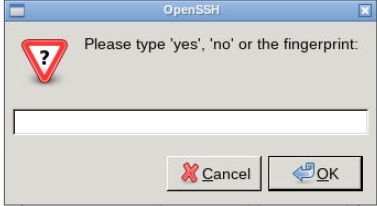

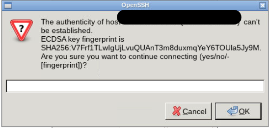

Hello,
I've installed netcat-openbsd and tried to connect.
Unfortunately when I try to connect I get:
If I write YES an error appears saying it can connect.
If I write my root password I get this screen:
If I type yes and then OK - I get that it can connect.
What I'm doing wrong?
EDIT: Probabily isn't possible with my setup ; I've setup that SSH is only possible with a SSHCert.
