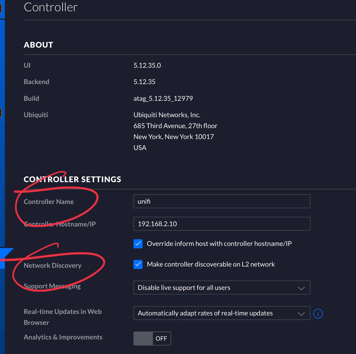

Many thanks for the insights.
Now I have the controller settings correct hopefully and the docker back in bridge mode.
couple of questions:
How is the controller name used? Can I just put anything in here?
Also, changing just the IP address and setting override inform wasn’t enough, I also had to set the L2 layer discoverability. What exactly does this do?
One final thing, sorry it’s a lot of questions but it’s a lot to take in, but I’ve noticed I seem to be on the latest branch which by all accounts is not super stable. Is there an easy way to recreate the docker with the 5.9 branch enabled without having to redo everything?

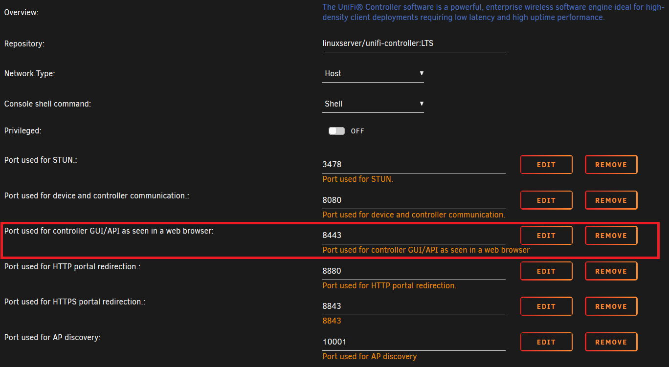

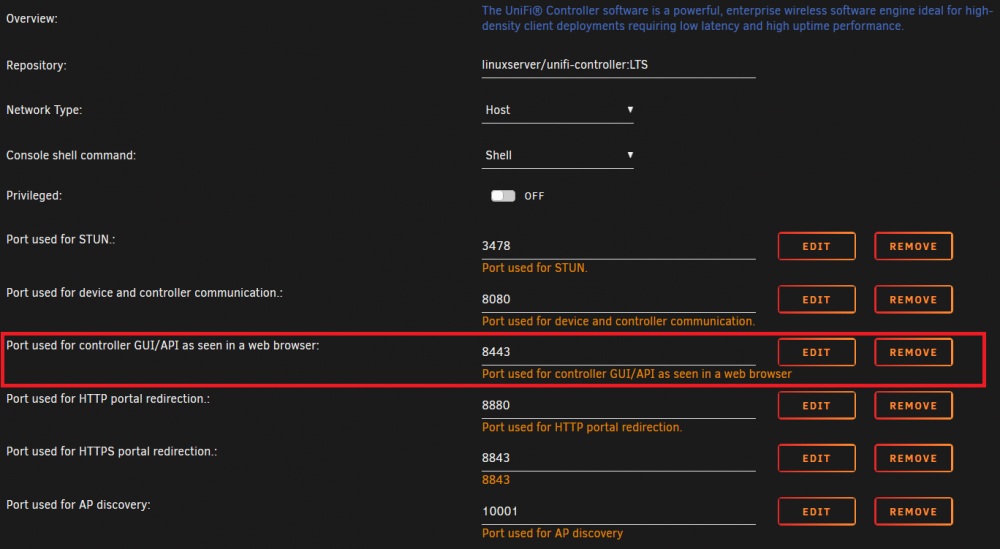

I have used this docker container for years and I have always reached the WebUI via TCP 8443. I'm 100% sure of this as have a bookmark in my browser pointing towards https://v.x.y.z:8443/
Anyway, I tried to access the WebUI using 8080. But there is no answer on this port either.
I wish I could have a look at the web server configuration of the docker container. But I'm not sure even where to start looking... or if I'm able to read the configuration once I find it. Maybe I at least would be able to verify what port it is listening on.
The correct port is 8080 inside the container and I guess 8443 is for Https. You can map it to whatever you want on the host side.
The problem in the post you quoted was that the user was not aware that por mapping can't be used in host mode.
What i was saying is that in host mode, even if manually creating the docker (-e 'TCP_PORT_8082'='8082') it does not adhere to the container port you give it, not the port mapping you give it - because as you mention, there is no port mapping in host mode.  Since there is another container using port 8080, the port will be in use and webui wont work.
Its currently working for me, in bridged mode, with a remapped port "8082", since no matter what I attempted, the container always created itself with port 8080 in host mode.
Aha, I think I understand you now! You mean the container seems to be fixed or hardcoded to use TCP 8080?
That should be no problem for me. I have no other docker container using port 8080. Or any other service running on my Unraid host using this port. I never have.
On the other hand, I have never used 8080 to access the WebUI. The "instructions" (see attached image) says I should use 8443. So I have always used 8443.
Anyway, just to make sure. If I switch to bridged mode and maps host port 8082 to container port 8080 I get another issue. My browser gives me SSL_ERROR_RX_RECORD_TOO_LONG.
thanks!
